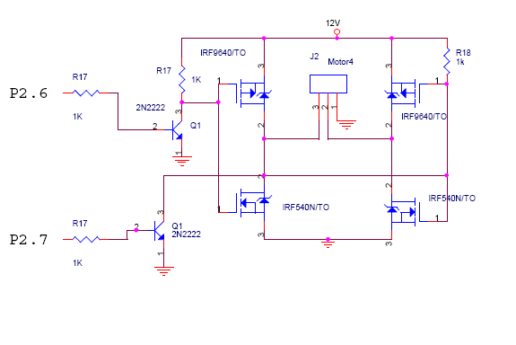

Hi, i tried to design many h-bridges and i found many faults in them and im in the need of a working one using MOSFETS not BJTs , the problem is its too hard to drive the MOSFETs correctly ... do someone has a working one cuz i want to send it to the pcb company and made it ... ? i googled i found some circuits but they cants stand more than 5A, and also im not sure whether they can work or not...

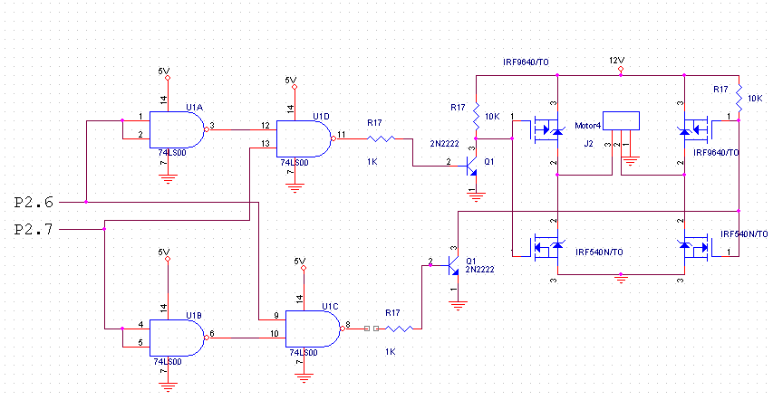

HI, my intend supply voltage VS for motors is 24V... that's why its hard , i got this bridge from audioguru and redrew it , someone experience told me it has a problem ( dead time) and dont how to solve it anyway ....

What frequency are switching at?

Shootthrough (or cross conduction) is a problem in any bridge (whether BJT or FET). It's when you turn off and turn on a pair of transistors in a half bridge at the same time, and because transistors take longer to turn off than turn on, you get a point when both transistors are on that produces a short-circuit.
You can control this by independently controlling all the transistor gates so you can shut one off, wait a bit, then turn the other one on. THe time you wait to make sure the first transistor is off before turning on the second is called dead-time. Your circuit uses a single signal to control both of them so you can't do this. But I think if you place the right gate resistors, you can slow down the time they turn on at (and turn off as well) to make it less of a problem. I don't know much about sizing the resistors or exactly where to put them, but someone else probably knows more.
You might want to place diodes across each MOSFET too (I'm sure you know why by now, please ask if you don't). But at 5A and such a slow switching frequency you may be able to get away with using the parasitic diode inside your MOSFETs (as shown in your schematic).
WHy does your motor have 3 pins and one goes to ground?
Other than that, I don't see any problems with your circuit (except that your resistors might be need to be sized a bit differently). Give yourself more credit!

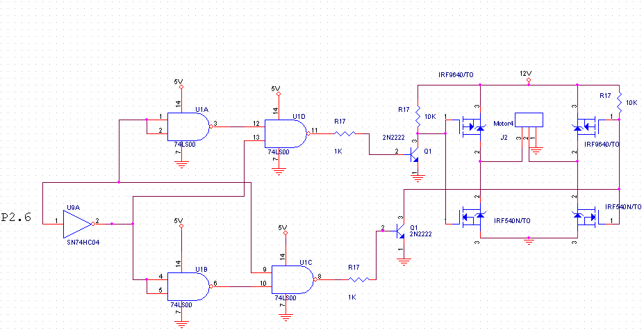

thanks for the reply, how about this schematic ? what if i want to use a more than 12V , and i know there's a max Vgs (+-24V)for the mosfets .. how can i solve this problem ?

For your circuit, if you want to use it with >12V, just disconnect your 10K resistors from the H-bridge supply and connect it to a separate 12V.
You have a bad connection on the bottom NAND gate. I don't think your NAND gates will not protect from shoot-through. What they do right now is stop all 4 FETs from being on, but they won't stop the High and LO FETs on each side from both being on for a short-time between switchings.
I never noticed this before, but wIth your current setup where signal pins are divided left/right you have to PWM both of them at the same time perfectly to prevent shoot through since every transistor will switch every PWM period. Do you see why this is? It's because you cannot shut a transistor off without turning another one on.
If you made the 2 control signals forward and reverse, rather than divide them up between left and right, it would ELIMINATE shootthrough problems (just when you switch directions wait a bit while all transistors are turned off to make sure they are off before reversing direction). Also, with that way you only need to PWM one pin to get the motor to move while the other pin is simply held low.

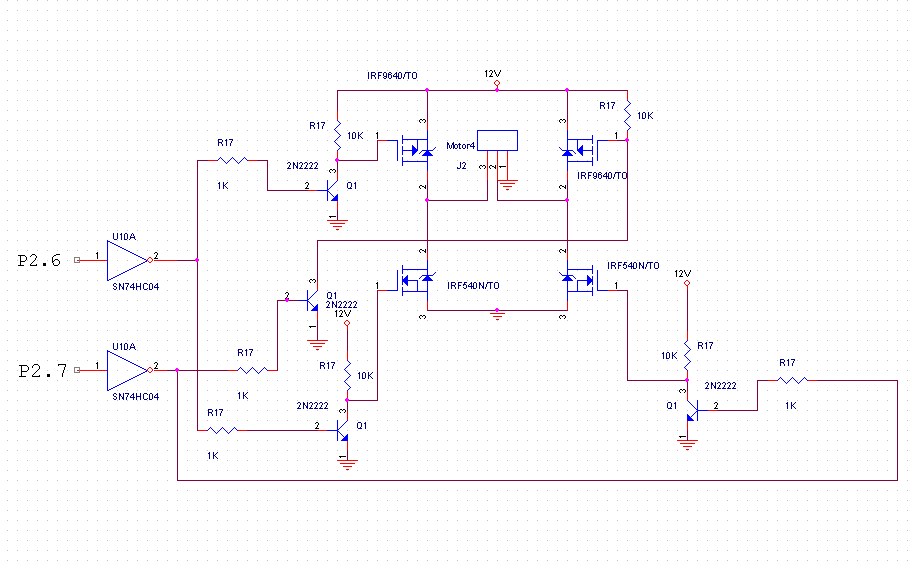

Hi , i changed the circuit and used 4 transistors with inverter , i think its now can work 100% ?

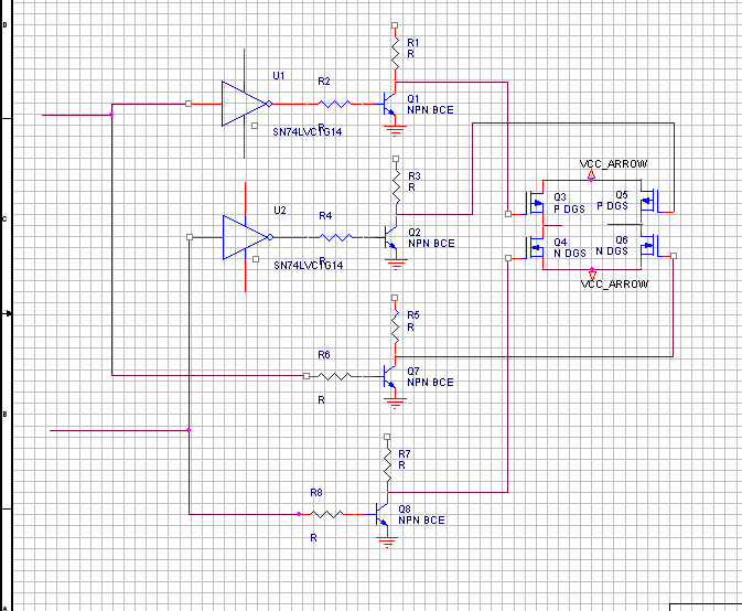

Place each inverter in front of the BJT base resistor for each PMOS so that the inverters do not affect the NMOS gate drivers. This will make it so that a HI signal will turn the PMOS rather than a LO signal (so the PMOS will behave just like the NMOS for the same control signal).
Then take the top-right PMOS and the bottom-left NMOS and connect their gate drive circuits together.
Do the same thing with the other two MOSFETs.
Do you see how this works?
EDIT: I added a schematic of what I mean. You can move the inverters from the PMOS to the NMOS. You probably should actually, since right now you have to apply a LO to the forward (backward) control pin to get the motor to move. If you move the inverters to the NMOS, then the logic isn't inverted anymore, and applying a HI to the forward (backward) pin will make the motor move.
(My PMOS's are upside down and so they are connected the wrong way. THe ones in your schematic are connected the RIGHT WAY. So don't change them.)
