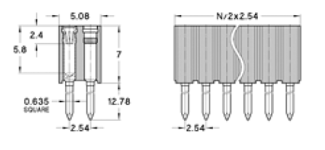

Hi folks, I'm looking for something like the following, dual-row, 34 pins total:
I'm looking for a manufacturer and part number but am having a heck of a time finding one. Would prefer to stay away from Samtec if at all possible (only because they are very proprietary).
Anyone know of a good source?

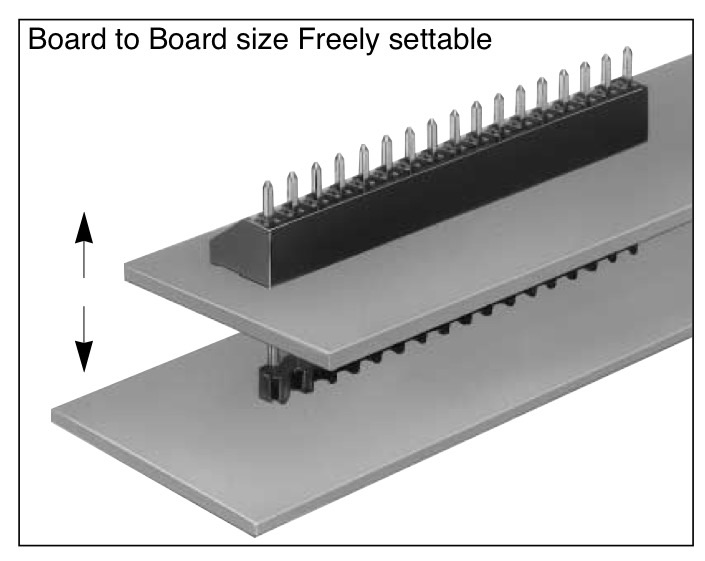

Thanks ronv. Unfortunately that's not quite what I'm looking for. As you can see in the image there is a single component acting as both the female header (on the top side of each board) and the male header (on the underside of each board). I am looking for that exact type of connection, with the specs I mentioned (dual row, 34-pin). Effectively it'll look like a female header with extremely long pins.
Not exactly what you're after, but I've started using these Hirose through-hole sockets. The pins extend through the socket, so the board spacing doesn't need to be exact.
You could use a long header and stack up several boards.
That is going to be tough, as the connector illustrated needs to be soldered to the TH board and have a long tail to mate to the next board. That is, there are no SMD stubs to solder to the top board, like the 3M connector (described below) has.
I checked out some of the 3M offerings for top and rear entry with spring and leaf contacts with surface mounting to the upper board. You could use the headers with long pins to accomplish what you describe.

If no one has mentioned it yet, look for PC/104 connectors. There are two in the original standard, designed for a board spacing of 0.600 in. Whoever makes those probably also makes other pin counts. Been too long since I bought any, so I'm blanking on names. I've use both press fit and a strange version that had little formed solder clips or donuts around the pins. No press-fit, you inserted the parts, which pressed the solder donuts between the board and the connector body, then ran it through a reflow oven. Worked perfectly first time out. Methode, maybe... Someone like that, a known-but-specialty connector company.

Hi folks, just thought I'd let you know I found the connector I need. It's Sullins Connector Solutions P/N PPPC172LFHN-M51(RC). I chose the PPPC182LFHN-M51(RC) though because I figured I could use two extra pins for keying. It's an "elevated" connector, but even so its "tail" length (lead length beyond the spacer) is 480mil which should be more than enough for my purposes.
Datasheet: http://sullinscorp.com/catalogs/101_PAGE114-115_.100_FEMALE_HDR.pdf

The part I'm using from sullins is a very common part, but it has extra-long leads. That's really all I needed--A female header with leads long enough to reach down to the next board in the stack.
