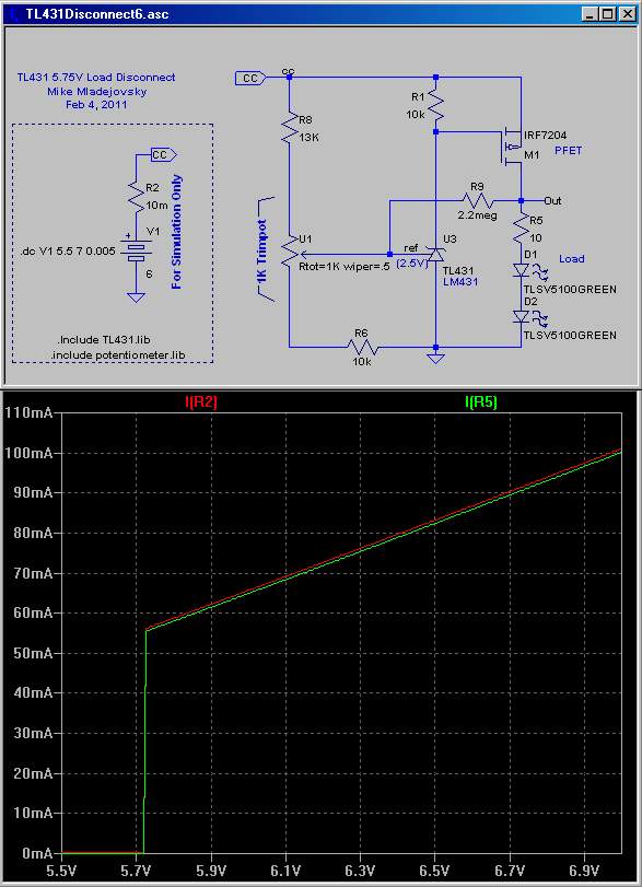

Here are some previous postings on this topic. Toward the bottom of the thread, the circuit was modified for ~6V. Modifying it for any other voltage is simple. Adding a bi-color LED (red-green) would also be easy.
So does your schematic provide a low voltage/current usage? I see where some wanted to use a relay, I did not see that in your circuit, which is good. Also, what resistors would I need to look at for changing upper and lower thresholds? How would you incorporate a bicolor led? I'm not very good at circuits so any help would be appreciated. Thanks again.
After looking at the schematic I understand what the components are and how they connect. I am not sure how the 8 pin irf7204 connects to the circuit?
Where is the IRF7204? You better post your existing circuit.

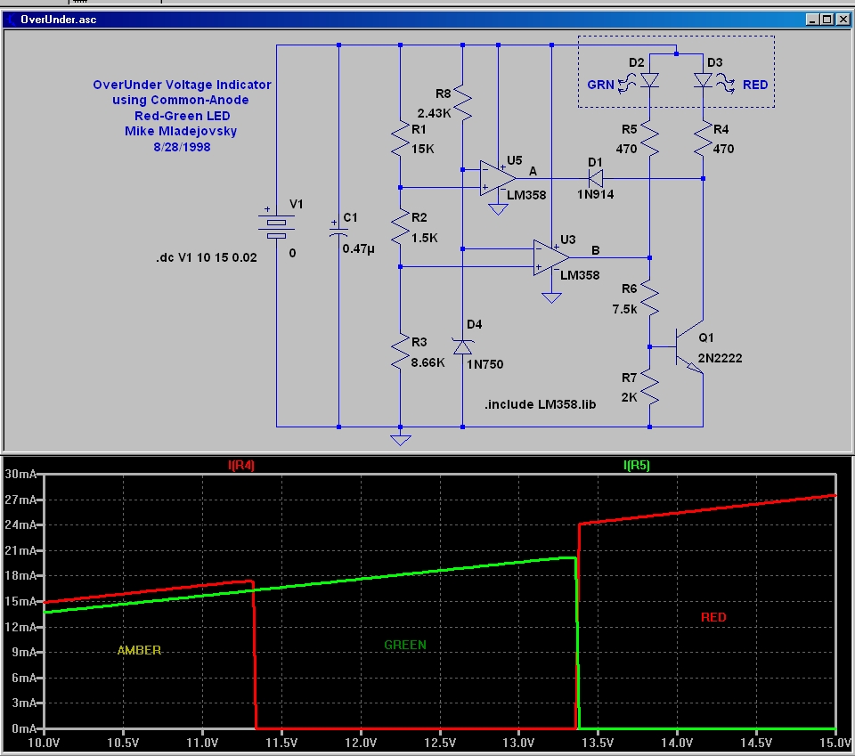

Here is an Over-Under circuit. It shows Red if the voltage is too high (runaway alternator), Green if the voltage is ok (in the middle), and Amber (mixture of Red and Green at the same time) if the voltage is too low. Look at the date when I created it...

What is the minimum operating voltage? Also, anything a little simpler that you can think of? I really only need two leds for over and under voltage. Any help appreciated. Thanks.
You still need two comparators, either the dual LM358 in an 8pin DIP package, or two of the LM431s. Eliminating the Amber state will reduce the parts count by ~ four.
What are the trip point voltages? What is the range of the input voltage?

If you just have one trip point (9V), then just use a 2-terminal bi-color LED, and a single comparator (LM431 or other). Or, with only one trip point, there is no reason to have Red and Green LEDs; just have a single Red or Green LED. If the LED is on, it means one thing; if it is off, it means the other (Binary=2states).
The window-comparator I showed earlier is Tertiary, it has three useful states (Red-Green-Amber or Red-Off-Green, Over-Ok-Under).
