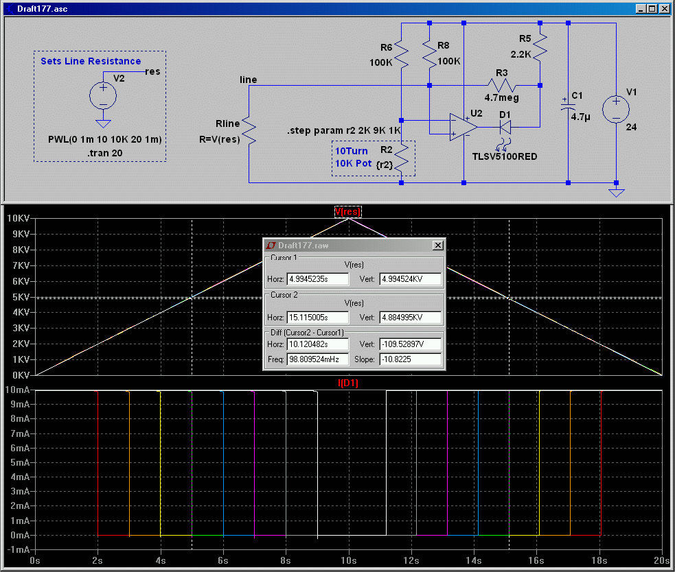

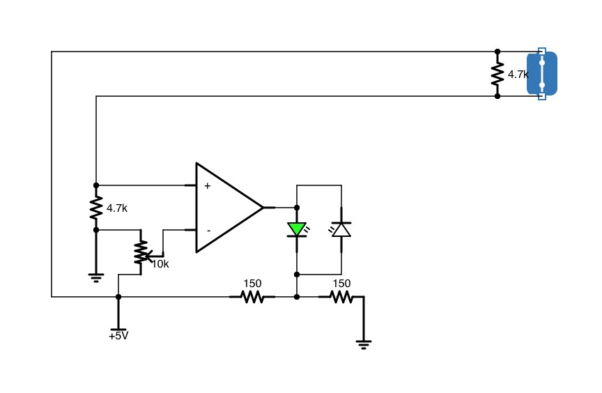

Here is my idea for a line tester:
Red LED turns on when Res is < X, where X is adjustable from 0 to 10K by setting the Ten-turn 10K Pot. If you get a 10K 1% precision pot with a turns counting dial, you can dial in the threshold resistance that causes the LED to switch..., e.g. 635 on the dial would be 6.35K
Circuit has a small amount of hysteresis to prevent the LED flickering.

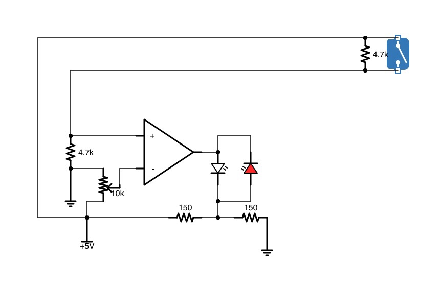

Are you looking for a security system-like circuit with End Of Line resistor?
Here is an example with an op amp that will switch red to green as the remote switch is activated. Swap the LEDs to revers color as needed. The 150 ohm can be increased if you use higher voltage.
A 10k potentiometer will let you compensate for long runs of cable so not a big deal.
View attachment 97126 View attachment 97127
Hi Gophert,
Thanks for your input , I assume if I change the 4k7 in your schematic will allow the comparison to the end of line to vary correspondingly ?
I would supply the circuit from the 24 volt given from the fire alarm panel but in the absence of the connection from the panel would switch in a 9v pp3 or similar. If I get really smart I might get it to auto switch to battery in the absence of 24 volt
I dont get it, never mind.
