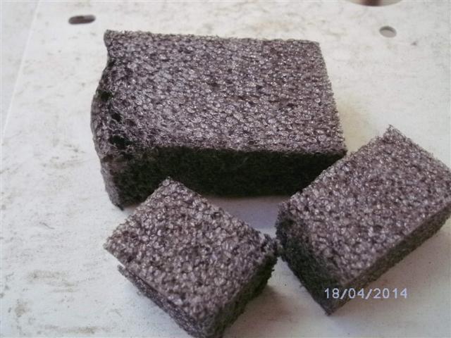

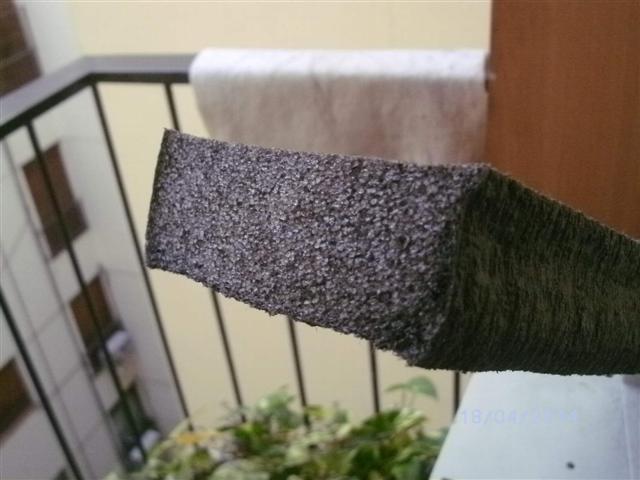

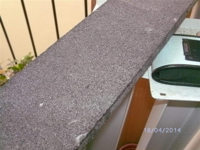

From time to time I find some pieces wandering loose inside the vessel's holds but much more frequently as packaging of electronic equipment. I tend to think it is coming from USA but I could be dead wrong.
It is very light, resilient and extremely easy to cut with an exacto knife.
I found it very useful to encase temporarily, displays and PCBs for their initial tests. I am sure that if a manage to glue it reliably, the final result would be good. Superglue and vinyl glue failed completely.
Does anyone recognize this material? If so, could you suggest what glue I could try?
Don't know if you can get it, but a product called "ShoeGoo" is very useful for gluing together stuff, like the foam packing you've pictured.
It's a clear, waterproof semi-liquid adhesive in a tube. Takes a while to cure (like 24 hours is best).
Does hot-melt glue work? Or does that destroy the material?
Have to borrow a hot-melt pistol and check.
