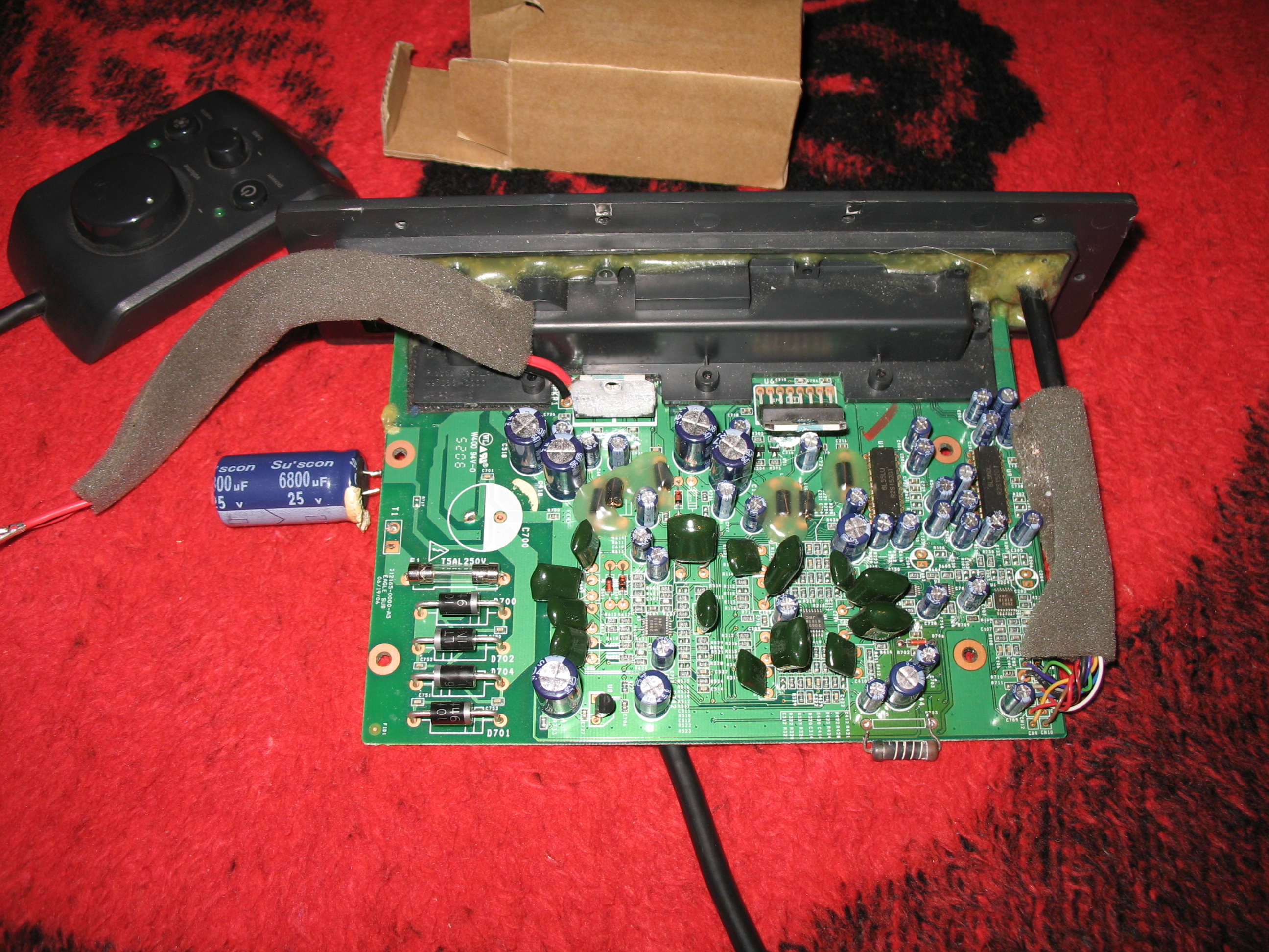

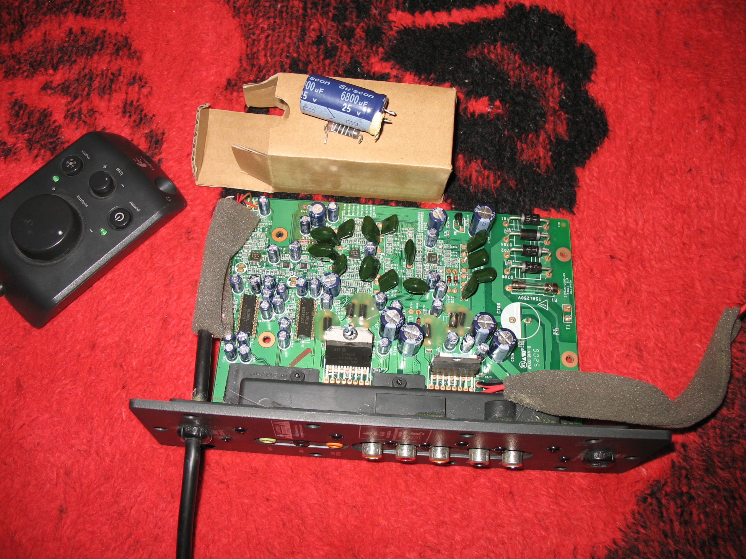

Hi everyone,
I just got a Logitech X-540 amplifier which does not work right. It is a 110V amplifier which was in a 220V-to-110V power converter while there was a power fluctuation (this is my explanation).
Symptoms: when turned on it is silent for like 2-4 seconds and then an intermittent low-frequency high-volume sound starts buzzing in all the speakers.
I opened it and i saw a pumped-up capacitor (the one in the power supply stabilizer, after the transformer, it is a 25V 6800uF capacitor) and also a resistor (a really heavy one) but the resistor is so fried out that you can`t see any colors, only the blown coil.
Please, can anyone help me with this?
I will also upload a few pictures of the amplifier board.
Thank you very much, I really appreciate :)

The cap should be easy to replace that resistor not so much if you can't find a schematic or find someone else that has the same unit to compare it to.
I'm looking everywhere for a Schematic.

Still what is extremely strange is that each resistor end is connected to a capacitor end. very funny. check out the R700 next to the C700 ( second attached picture of this thread )

You need to follow where it connects to, to give us a clue as to what it does.

Just been looking at the datasheet for the chip, it's maximum voltage is 22V, and the capacitor is rated at 25V - I would suggest that the supply has gone higher than 25V, blowing the capacitor, and quite possibly taking the chip as well.

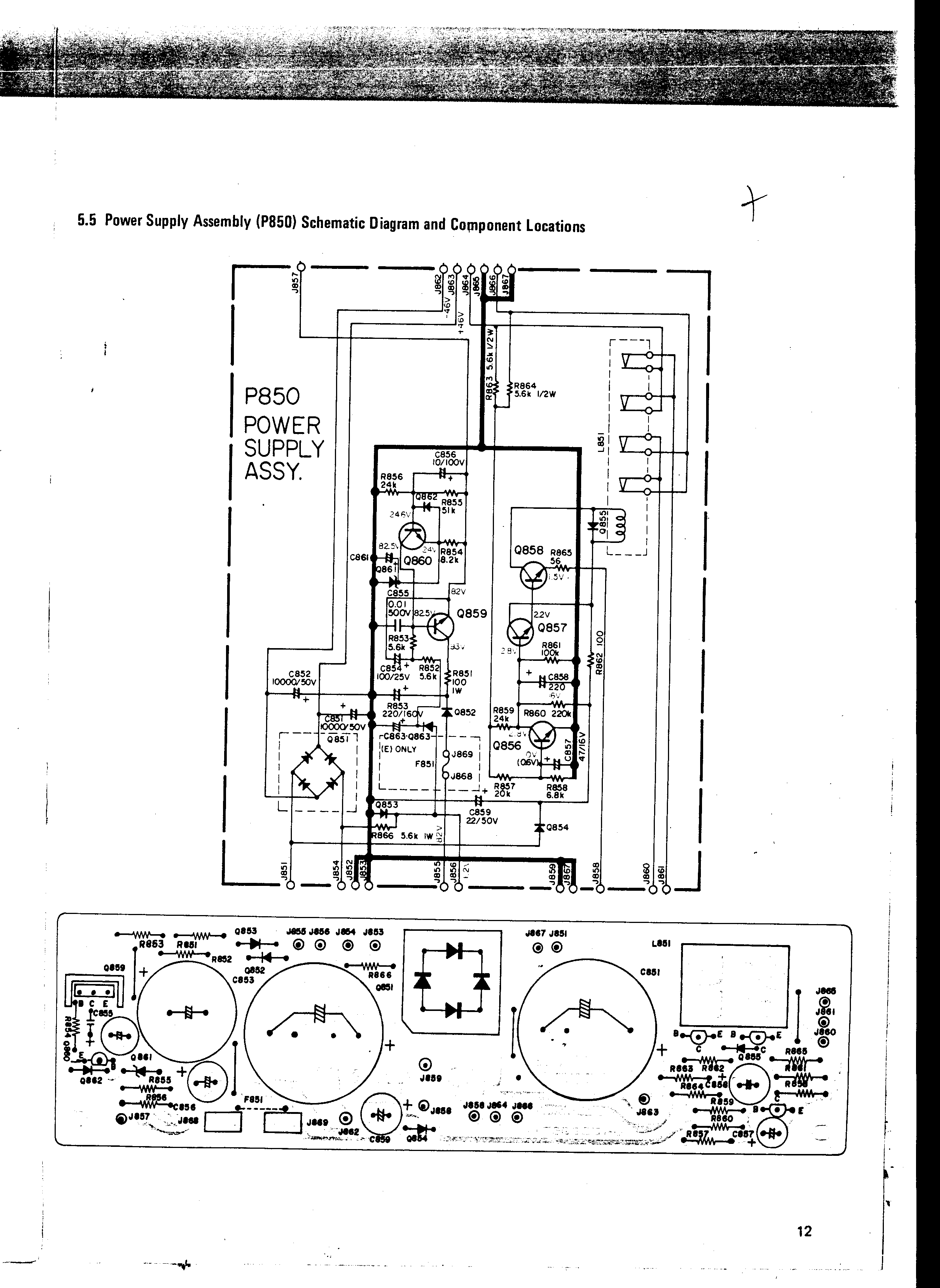

I disagree with Nigel on bleader resistors. But, I think yout resistor serves a different purpose. It may be a way of stabilizing the voltage regulator in the power supply or stopping the switch from making a popping sound when the power is turned on.
Look at these schematics from a Marantz, There are bleader resistors all thru the schematic.
I suggest you reconsider what you think a 'bleeder' resistor is, and does - I see none in that diagram?. There are two large 10,000uF 50V capacitors, any bleeder resistors would be across them - there are none.
You win Nigel
How about this application? There are Emitter Resistors etc in this power supply that are 2watt resistors not bleaders.
