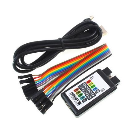

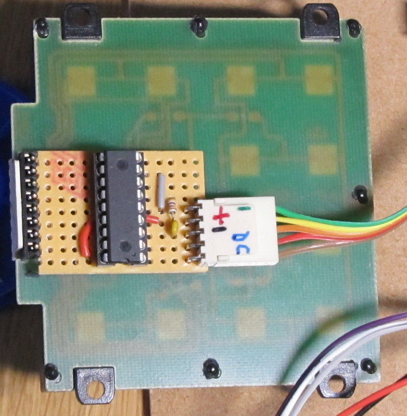

I have had one of these Hobby Components USB 8CH 24MHz 8 Channel Logic Analyzer / Analyser for some time , the SW for it on windoze at the time was a pain. since moving to linux.mint 20 , had another go , wow . program (PulseView... see link) was installed (under linux softwear manager ) and runs like a dream in 30 seconds, loads of protocol decoders ,( 61 ! even CAN and IR ) with a usable bandwidth . It found my shorted strip board track. I had a data IO short to SDA on a MCP23008 i2C port expander running a 4x4 matrix key pad.
https://sigrok.org/wiki/Main_Page
