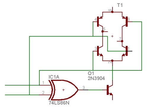

I have an H-Bridge chip and I need to be able to make sure I dont have both inputs on at the same time or it will cause a short from +V to Gnd. So, I have two inputs from the ATmega and two outputs to the H-Bridge. I need a circuit that will allow each input to control its corrosponding output but I need all outputs off if both inputs are on.

Would this circuit work?
Feel free to draw the fix on the above picture. I was mostly worried about if the XOR gate would work or not. The H Bridge needs to turn off if I accidentally put a high on both forward and backward pins (short).
So will the XOR logic work?

OK, I figured out the H-Bridge and it works perfectly. Back to my original question...how to provide protection from accidentally turning on both inputs and creating a short. I tried using an XOR gate connected to a transistor but that didn't work (I didn't expect it to). I know I can use the XOR gate, but I'm not sure how to use the output to turn off the circuit. I could use a small relay to cut off power.

I think you're thinking about it the wrong way. The logic should turn on the H-bridge transistors themsleves (with some driver circuitry if nessesary). For the top transistors you want a PWM input and a control input - if the control input is high you let the PWM through if its low you turn the transistor off.
Top Transistor 1 => (Direction AND PWM) : if Direction is high PWM goes through.
Top transistor 2 => ((NOT Direction) and PWM) : since you use the inverse of direction you can not have the PWM going to both top transistors.
You Turn the bottom transistors on all the time with the direction bit and the inverse of the direction bit. You insert a small turn on delay when the direction bit changes to prevent shoot-through as all the transitors turn off.
OK, I was trying to have an input for forward and an input for backward and put PWM through to both inputs. I guess I should try having PWM on one input and forward/reverse on the other input. WIll probably solve a lot of problems.
