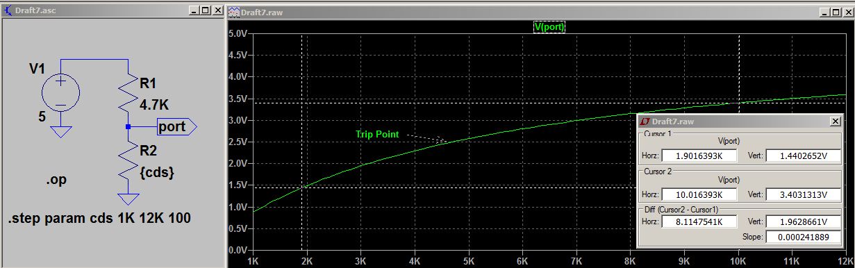

Issue is obtaining a logic level below 1.5 volts for LOW and higher than say 3v for high. want to have some lee way if possible.
We need to know the resistance of the photo cell when fully illuminated, and when covered with your finger. You should mount one just the same as you intend to mount the others, and make the Ohmmeter measurements in place with the ambient illumination you will be eventually using...

my LDR = 1.9K in light and 10K in dark sorry I failed to post this info.
been breadboarding and thought I have a solution but my circuit didn't work as hoped.
5v ------LDR-------/\/\/\/\-----GRD
^ 1 K
to port
light = 2.8v
dark = .74v
my code for one port grounding the port works so code may not be culprit. Would think HIGH (2.8v) is ok and LOW(.74)???

I would guess that if you are powering the PIC on 5V, the port trip point is pretty close to 1/2Vdd, or ~2.5V. I ratio-ed R1 to more-or-less center the transition on the supposed trip point.

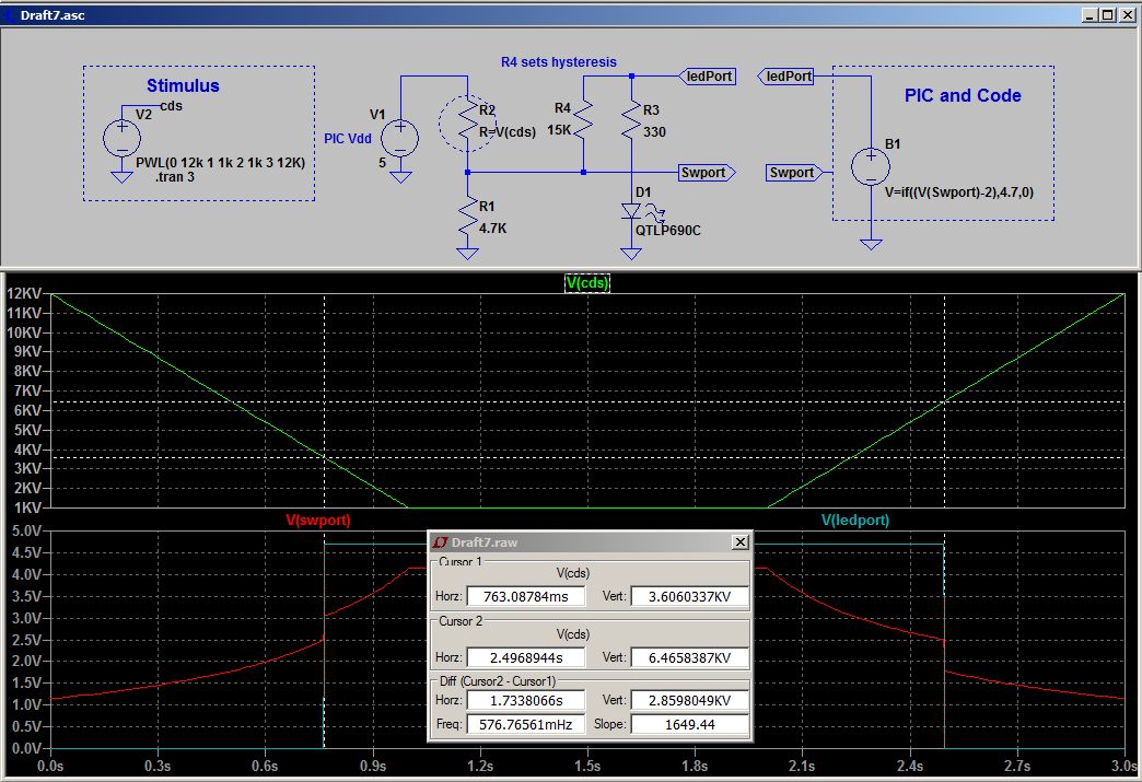

Will you be driving a LED with a different port pin that shows the state of each switch? If so, I have an idea how to add some hysteresis to each switch.
yes each led is powered off a different port pin

Here is how to add some hysteresis to prevent the "switch" from chattering:
Think of V(cds) as being the resistance of the photocell; 2KV=2KΩ, and so on.
If you had code running in the PIC sort of like this: If(Swport) then ledPort=high else ledPort=low, then wire a feedback resistor from ledPort to Swport like R4. This provides enough hysteresis such that the photocell resistance has to go to 3.6KΩ to "close" the switch, and then to 6.5KΩ to "open" it.
A "software" assisted Schmitt Trigger?
I tried bread boarding Mikes suggestion and got no where fast.

I have done the Schmitt Trigger trick using digital ports on an 5V Arduino, and it worked first time. However, I knew a-priori the voltages that I wanted it to turn-on and turn-off. I'll bet that your problem is that you really dont know at what LDR resistance you want the "switch" to turn-on and turn-off.
I would hook up as shown in post #5, but feed it into an ADC pin. Write a small test program to display the actual ADC readings as you cover the LDR with your finger. I'll bet that the readings are not mid-scale as they should be if the LDR resistance is ~5K at the trip point.
