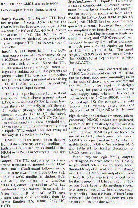

never mind going through your pile of books. i have attatched a portion of the article which compares various logic IC families

Yup I have the Electronics bible.
We did use that but it really doesn't say what each type is
