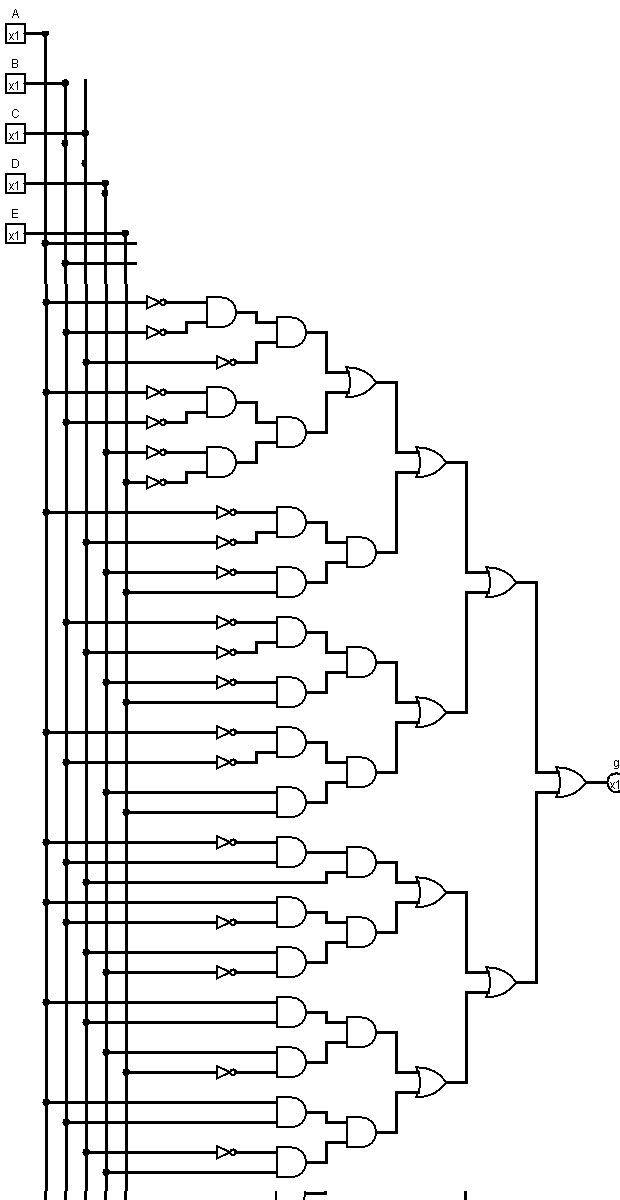

So i was using the 3 basic gates IC (7432, 7408 and 7404) and when i use the 7432 the output was always high but the inputs are low or simply, 0 + 0=1.why is this happening and how to solve it. I tried using different 7421 IC's yet with no changes. I would like know other tips as well inbreadbarding.

I also encountered problems like even though the output should be 0 which will not light the led but the led still ights up even though its a little but when the output is high, the led lights brightter.

Is that your circuit??
Have you tried testing the chips individually? How are you powering them?
I suspect that the circuit with the hundreds of gates is built on a solderless breadboard that causes them to oscillate.
The schematic is missing many 0.01uF or 0.1uF ceramic supply bypass capacitors that helps the gates to stop oscillating.
