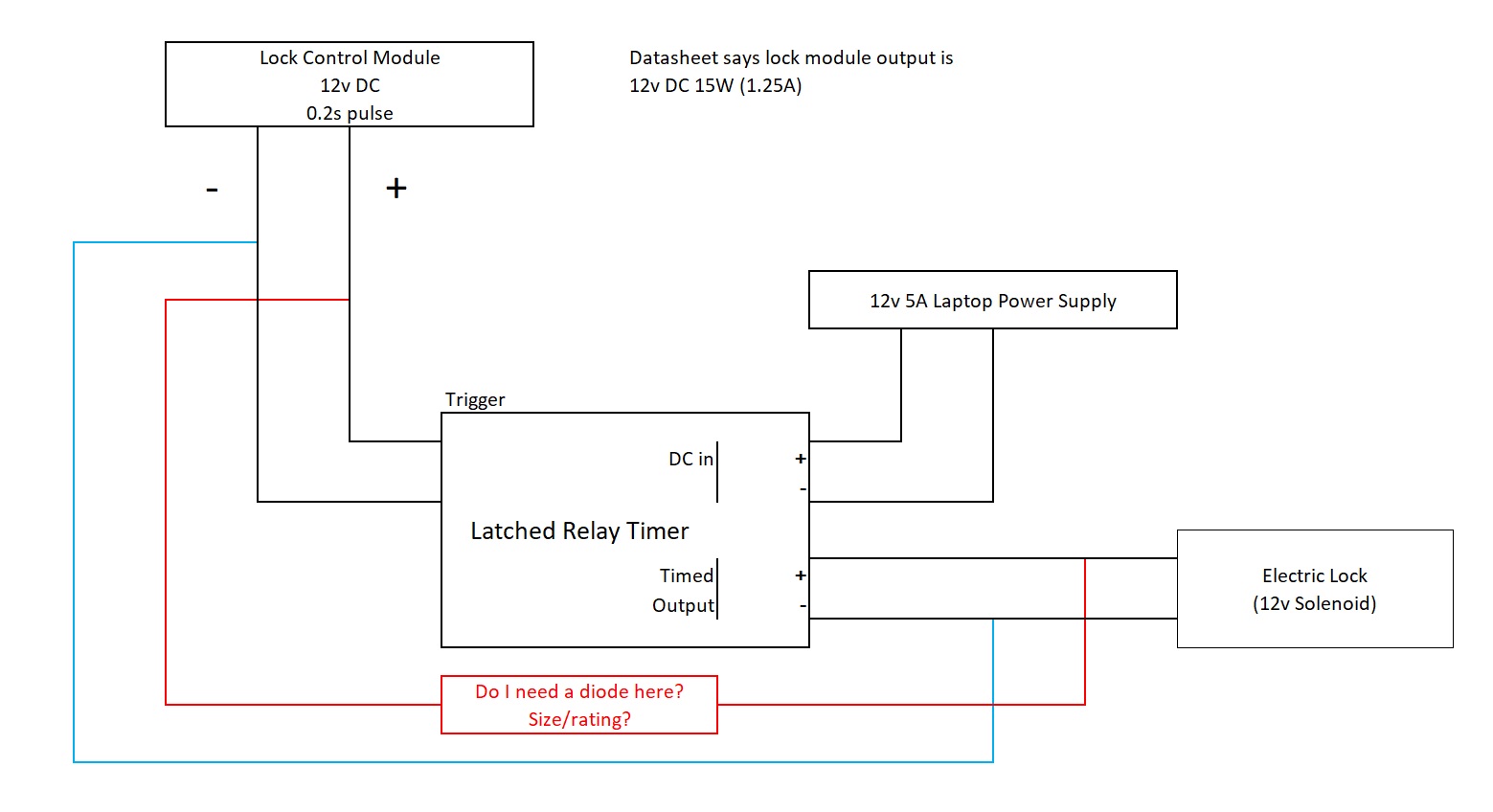

Extend the lock solenoid activation period to around 3sec using the 0.2sec pulse from the Lock Control Module as a trigger
How far have I got
It's been a long time since I've done much in the way of practical circuit work but I can create an extended 12v pulse by using a timed relay taking power from an independent 12v power supply (thinking of a 12v 5A laptop supply), and using the 0.2sec 12v pulse from the Lock Control Module as the trigger. I've tested the timed relay hookup using one old car battery as the trigger and another as the power supply (don't see why the laptop supply won't work) with a 12v lamp as the load, and I can generate timed 12v outputs
What I would like to do is take a 'belt & braces' approach and connect both the Lock Control Module and the timed power to the lock so that if there is a problem with the relay board the lock will still receive the pulse from the Lock Control Module - this is shown by the blue and red lines below.
In order to do this I think i require a diode on the +12v line to isolate the two power lines. Is this correct?
- Do I require one on the -ve line as well?
- What size/rating diode would be required?
- Am I barking up the wrong tree and this won't work?

That looks good with 1 diode where you have it.
Any diode that is good for 2 amps or better will work.
You need an "Off delay" timer, or a multifunction timer that includes off delay.
They need a permanent power supply to A1 (+) and A2 (-) terminals.
The input signal is to S, B1, Y1 or whatever the data for the unit shows. That needs 12V applied at a trigger.
A floating contact would connect between that and +12V. or a device that provides 12V out would have its negative connection to the timer A2 terminal and the 12V pulse to B1 / Y1.
Then set the time control for the output duration you require.

Thank you, but I've already got this one from Amazon
I've already got it working with that module - tested using two car batteries and then, this afternoon, I have it working with the gate control panel using the 0.2 sec pulse as a trigger. It holds the gate lock solenoid in the open position for the configured time - currently set at 4 seconds while I'm testing, I can hear the lock solenoid trigger and then reset shortly after the gates are open.
I want to allow for failure of the 'cheap' Amazon module by sending both the 0.2sec pulse from the gate control panel and the 'longer' pulse from the timer module to the gate lock - so my question was more about connecting both 12v supplies to the lock without them interfering/damaging each other
