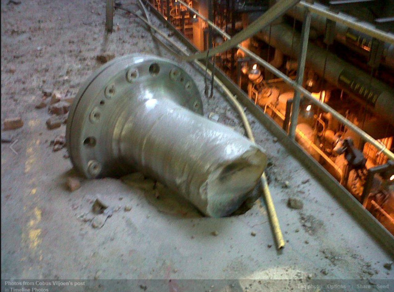

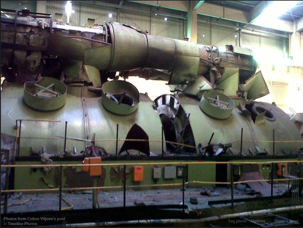

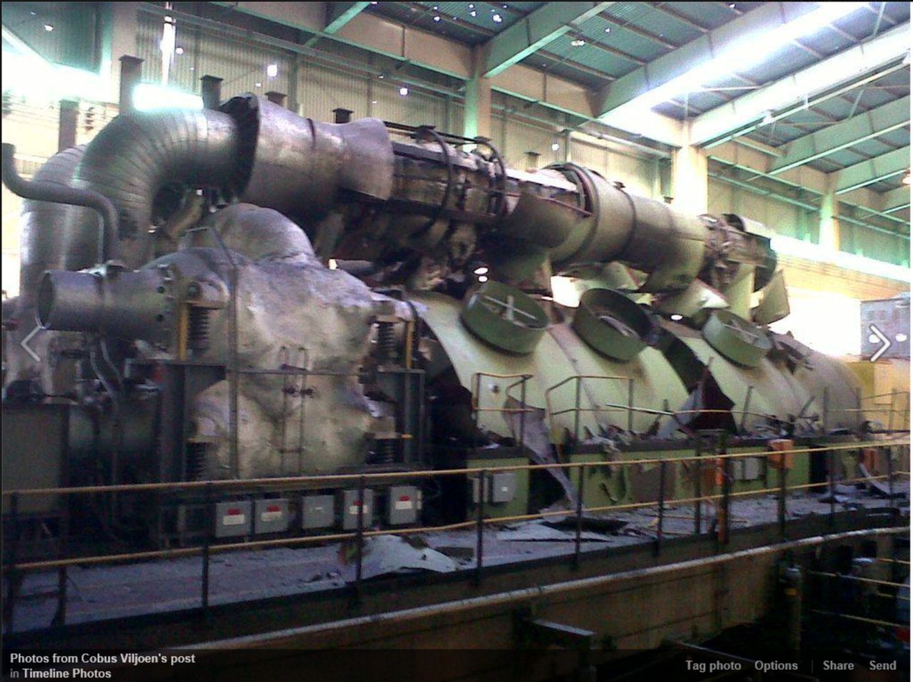

And two more known incidents:
https://www.timeslive.co.za/local/2...ower-station-coal-silo-crack-and-disintegrate
https://www.timeslive.co.za/thetimes/2014/11/27/eskom-ashes-to-ashes

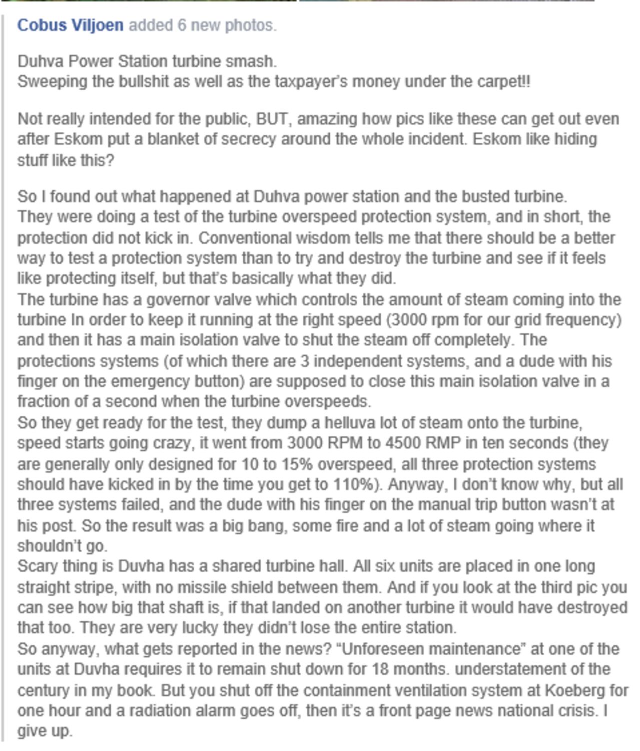

Naval turbine generators have a mechanical over speed trip mechanism. After overhaul, the exact trip speed is adjusted by adding shims in the mechanism. The trip mechanism will trip at too low of speed with no shims installed; the unit is tested without shims to determine the trip speed, and shims are added to increase the speed to the right range. Typically, the total thickness of shims required in about 0.125".
A team was adjusting the trip mechanism on a recently overhauled turbine. One guy was reading the speed using a strobo-tach – a high-intensity light flashing synchronously with the shaft will make the shaft appear to stand still. If you've ever used a strobe, you'll know that if it's flashing at 1/2 the shaft speed, the shaft will also appear to freeze. There are procedures to follow to make sure you're reading the actual speed and not a sub-multiple.
The team is inserting additional shims to reach the right trip speed, but they were having a difficult time getting the trip speed high enough. Instead of ~0.125" of shims, they had over an inch, and the speed wasn't high enough yet. To make a long story short, the guy reading the strobe was reading 1/2 shaft speed! The generator was running at almost twice the rated speed when the generator rotor expanded so much that it hit the stator, causing it to jam solid! Parts of the turbine exploded out of the casing and bounced around the engine room. Fortunately, no one was seriously hurt but the turbine generator was destroyed!
Analysis of the problem was pretty simple. Eight times the normal shim thickness in the over speed trip mechanism and a generator rotor expanded by over 1/4". The team that was doing the work doesn't believe this actually happened – it was the quietest turbine they had ever seen. In fact, all the turbine blade-pass frequencies that are the noisiest part of the turbine were beyond the range of human hearing when the turbine was at nearly twice the rated speed.
The procedure has been changed, requiring the use of optical tachometers that can't be fooled the way a strobo-tach can. A very expensive lesson learned.

However our problems are bigger here if you follow the two links under the photo's.

Pretty bad situation out there in S.A. Pure incompetency to overspeed that generator. The builders of that silo should be held responsible for poor design or workmanship. No doubt they will be hiding.
