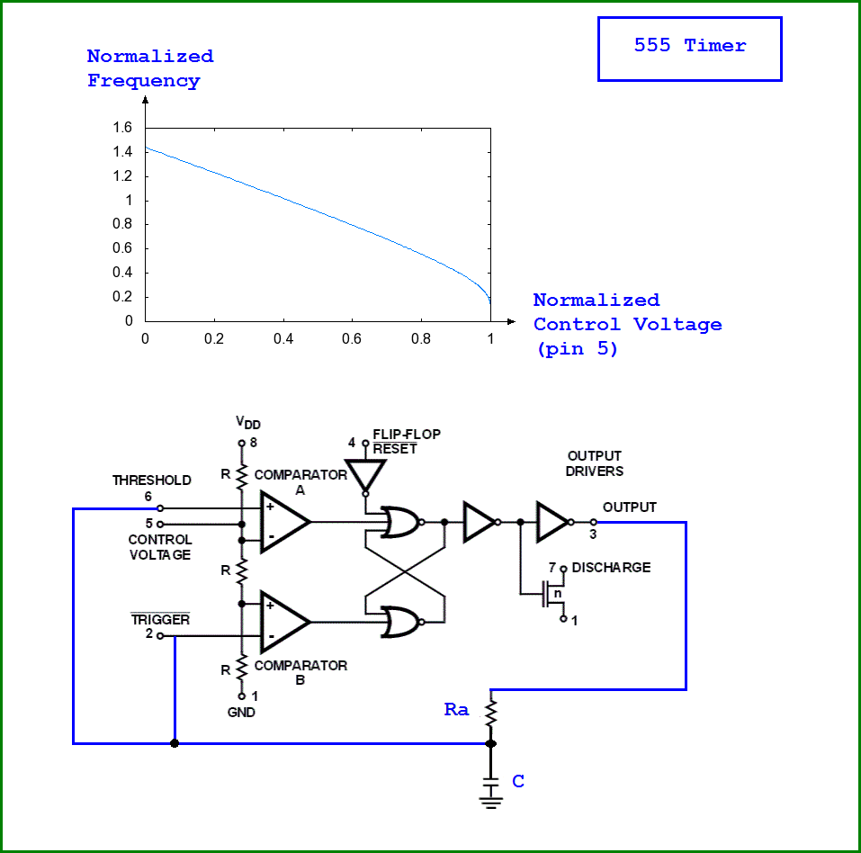

A couple notes about using the control voltage pin.
First, once you use the control voltage the temperature characteristic of the circuit then depends entirely on the temperature dependence of the control voltage signal.
Second and for some applications a little more important, once you use the control voltage you loose the independence from power supply voltage variations. In normal operation the oscillation frequency is independent from the power supply voltage level, so in theory at 5v you'll get the same frequency output as at 10v. Once the control voltage pin is used to change the output frequency however, power supply variations begin to have an impact on the output frequency again due to the loss of the Vcc/3 discharge and 2*Vcc/3 charge symmetricalness of the charge and discharge threshold levels. As the power supply level changes so does the frequency, so some testing and/or simulation is a good idea. If your supply voltage does not vary that much it may not matter as much, but keep in mind that not all voltage regulator chips are perfect.
I did a plot on the control voltage vs output timing a long time ago and i think i posted to this site. Not sure where it is now but we can do that again if needed. One thing i remember is that it is not linear with control voltage input.
For a free running oscillator there are other ways to do it too which are not very hard to do, such as using an LM339 or similar and set up the three resistors yourself.
BTW, the CMOS version has the 100k resistors but i dont know if they are subject to change in any version, bipolar or CMOS.
LATER:
Here is a graph of the normalized output frequency vs normalized control voltage. Note that setting the control voltage to zero will mean there is no charge/discharge difference so it wont work well. This is for the 50 percent duty cycle version of the Astable oscillator connection (that's where the output drives one resistor to the capacitor).

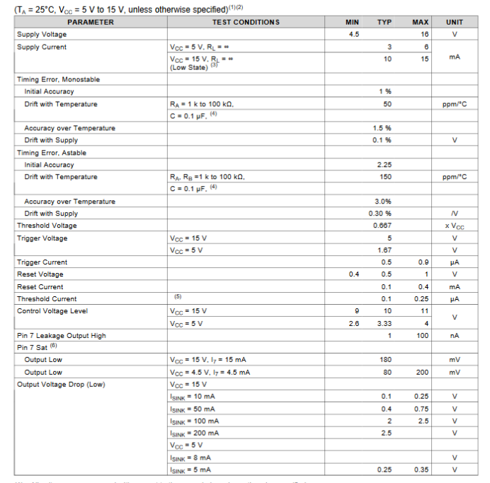

Hy,
Some interesting observations from you all.
Guess what, the answer to my question has been staring me in the face all along. It is on the datasheet- it is just that I have been reading it incorrectly.
The 'Control Voltage Level' shows the permitted control voltages, both for 5V and 15V supply lines. I had been reading this as the level that the control voltage would assume on this pin. It is not; it is the maximum range that the control voltage can be set too.
So, to answer the initial question, the lowest voltage that control can be made with a 15V supply is 9V and the lowest voltage that control can be made with a 5V supply is 2.6V. I bet, in practice, you could go lower than 9V with a 15V supply but that would be outside the specification stated low limit. Of course, the low voltage limit may be constrained by something as basic as the current flowing through the upper resistor in the divider chain.

Hello again,
Say whaaaaaa???? :)
Where are you reading this spec from spec <chuckle> ?
The listing shows the possible OUTPUT voltage of the control pin doesnt it? It should be roughly Vcc*2/3 for any Vcc, so for Vcc=6v it should be 'around' 4v, but you can apply as INPUT any voltage from -0.3v to Vcc+0.3v without damage.

Hy MrAl,
When the Signetics NE555 timer first came out there was more documentation about using the control pin. Then National Semiconductors launched the LM555 clone and Texas Instruments subsequently acquired National. This is what is on the latest TI (National) data sheet (see link below):
(1) The Control pin is an input as stated in the first table in data sheet. I had forgotten this.
(2) If the Control pin is not used for frequency modulation, it should be decoupled to 0V by a 10nF capacitor, (no larger or the turn on current could damage the top resistor, no smaller because the decoupling would be insufficient). The statement in brackets has been removed from the latest data sheet, but a 10nF decoupling capacitor is still called up in the application information on the data sheet.
(3) When pulling the frequency by applying a voltage to the Control pin, the levels shown on the data sheet against 'Level' are guaranteed to work, but not outside those levels. This is what I think. A Phillips (Phillips bought Signetics) application report for the NE555 says that, 'a control voltage of between 90% and 45% of Vcc are safe, but wider voltage levels have been used successfully' (pretty definitive).
I'm not sure about putting -0.3V on the control pin, but that may be OK now if the delicate top resistor in the divider chain has been beefed up on modern 555s. It certainly was not the case . The limit on the value of the decoupling capacitor on the Control pin of 10nF tends to counter this though. Also, with a supply of 15V this would imply a current of 5mA through the top resistor (assuming a nominal 3K value) which in turn would mean a dissipation of 75mW which sounds a bit heavy for a substrate resistor. By the way, I see no information on the data sheet about allowing -0.3V or VCC +0.3V on the Control pin. I may have missed it though.
The point is, not what voltage can be safely placed on the Control pin without damage, but rather what voltage can be placed on the Control pin and have the 555 still function. In the application that lead to the original post, all that was required was for the 555 to operate on 12V but the control voltage be set to 0.666 *5V by a voltage source, to allow the 555 bistable flipflop to be toggled by a 5V square wave on the trigger and threshold pins.
There is certainly some confusion about the word 'Level' on the data sheet, which could mean input or output, but the data sheet quite clearly states that the Control pin is an input (first table). Also, the reason why I think it is an input is because if it were an output the wide range of voltages would imply an equally wide range of resistor values which would not make sense when the absolute frequency and mark to space ratio accuracy are considered. The other point though, is what possible use would the output voltage on the control pin be. On the NE555 data sheet the output voltage of the Control pin is give as around 0.666 * Vss +- 0.6V, but once again this error is not compatible with the other parameters listed on the NE555 data sheet.
The data sheet for the LM555 is particularly bad with only nominal values stated for critical parameters dictating absolute accuracy and deltas caused by changes of temperature and supply line voltage.

LATER:
I accidentally posted the "control voltage vs oscillation period" graph instead of the "control voltage vs frequency" graph previously, here is the corrected graph (assuming you dont mind going from 0v to +Vcc with the control voltage). Since there are at least two different ways of doing the astable, i posted the circuit with it which also shows the internals of the 555 for convenience.

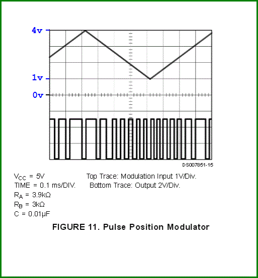

Hello again,
I found this on one of the data sheets, although it uses a 5v power supply.

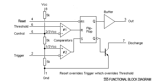

Hy,
I too have been looking around for data on the 555 families: there is a lot of it. I had forgotten about the round tin can version that we used for the first few years.
As a result of the information in this ETO thread, and on the net, my personal conservative rules for using the control pin will now tend to be:
(1) Nominal value of resistors in chain: 5K Ohms
(2) Maximum input voltage (operate): Vcc-1V
(3) Minimum input voltage (operate): 1.7V
(4) Linear voltage to frequency range Vcntrl: To be defined, but probably a delta of +-1.5V

This data flowed functional block diagram, modified from the net, sums up the 555 nicely:
