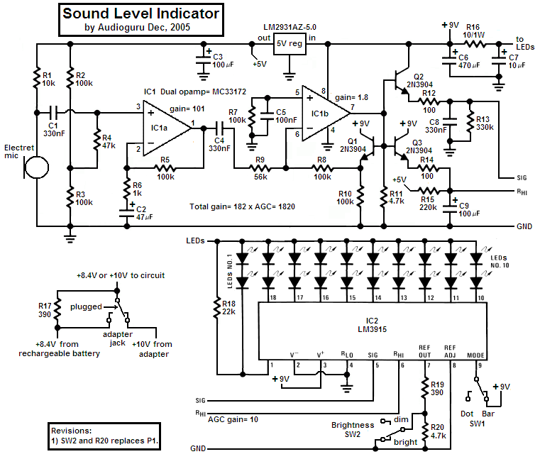

Here is my Sound Level Indicator circuit that is almost 10 years old today and still works perfectly after being turned on all the time:

How would you connect the LM3915 to your peak detector circuit? You show the output that you connect to pin 5 but what about RHi that you show on your original circuit with the mic?

The output of my peak detector connects to the SIG input pin 5 of the LM3915. I use a slower output of my peak detector to feed a DC voltage to the Rhi pin 6 on the LM3915 for it to change ranges so that I get an additional 20dB of loudness range.
Oh i see great. Most schematics seem to show RHi connected to the REFout pin, I guess it would be OK to do this combined with your line level peak detector circuit, then I would just have a static range?
Thanks for the help
The Rhi to Rlo voltage divider in an LM3915 is typically 28k ohms. I bias it with a 220k resistor R15 connected to regulated 5V so when audio levels are low causing transistor Q3 to be turned off then Rhi is 0.565V resulting in very high sensitivity. When sounds are loud then Q3 turns on making Rhi as much as 5.57V which reduces the sensitivity 10 times (20dB). I get a range of 50dB.
If I didn't use Q3 to change the range then only the top LED would light most of the time or the sensitivity could be turned down then no LEDs will light most of the time. Then the range is only 30dB with Rhi at one voltage.

You could use an LM358 dual opamp since its inputs work fine down to 0V and its output goes down almost to 0V without a negative supply. But an LM358 is noisy then it might show an output (of noise) without an input.
I used the MC33072P dual opamp because it does everything I want and uses low battery current. www.farnell.com is a British electronics parts distributor with warehouses all over the world and their American office has more than 1000 of this opamp in stock and many MC33078P that is even better but uses more battery current.
