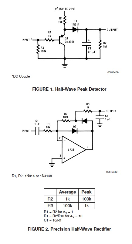

For the best performance, would you all suggest adding both the rectifier and the half wave peak detector? Placing the rectification first and then the peak detector and then that output into my LM3915?

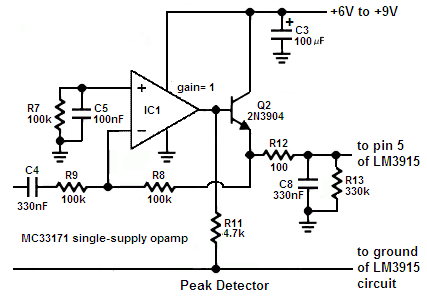

I use a peak detector for my VU meter because it clearly shows very short duration peaks that are not seen without it. Also it keeps all LEDs at the same brightness.
The transistor/diode version needs an input of 10V peak or more to avoid a huge error.
The opamp version needs a dual-polarity supply.
I use a single-supply inverting opamp circuit for my peak detector because it works with its inputs at 0V and does not need a negative supply.

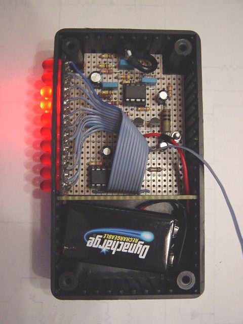

I made my Sound Level Indicator project on Strip-board, not on a pcb.
It looks like this:
