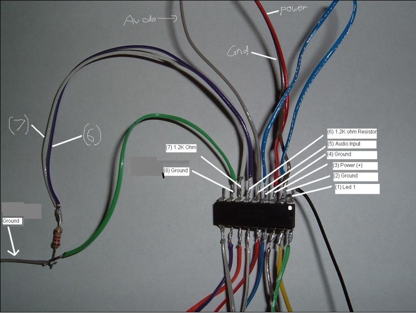

Thanks for all the replys. I got my circuit diagram from www.gideontech.com. The other circuit i have no idea where it is from, i dont have a picture of it on my computer as i printed it out and deleted it.
I dont beleive it is my power supply as i have tried the 12 volt from my pc, and a 12 volt Transformer.
Yes Pin 9 is disconnected from everything and yet it displays in bar graph. Sometimes the top Led's will light up, but instead of the display moving heaps. it just sits around leds 6,7,8. It dosnt look very nice, I thought this IC would have the all leds moving heaps.
If Anyone else has done this circuit could you please post a photo of it.
Edit: Resized Picture.
:shock: That poor IC.
with chemelec's advice, you'd want to connect the ground of the resistor (grey wire on left of pic) to pin 2 of the IC, so you only have one ground coming off of the IC.

wow it works, very responsive now. But It is still displaying in bar mode with nothing conected to Pin 9. Anyone have any ideas?

If you've got it wired as the picture above I would have thought it's got a good chance of being unstable, it could well be oscillating - you should'nt wire things with long wires!.
I think the circuit is now working as expected.
You are feeding it with an AC signal, the instantaneous voltage will be constantly varying which is why your eyes see a bar display, if your eyes were fast enough you would see a dot display.
As chemelec suggested, you need to rectify the signal before applying it to the LM3915.
Have a look at the LM3915 data sheet. (Google LM3915).
Ok i guess this is how it is suppose to be then. Not very dotty but oh well lol. I have put positive power on pin 9 and it makes the led's glow more brightly.

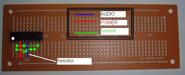

I have included a rough image of what i might transfer to a pcb.
Can anyone see anything wrong with this circuit.
For such a simple circuit, I'd recommend just using some perforated board (has a grid of holes drilled 0.1" apart, the same spacing as the pins on the IC). Then just solder wires to the leads.
Unless you are planning on getting into making various circuit boards, then I'd suggest going the printed circuit board route. Materials can get kinda costly.

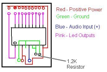

Ok back with a pcb proto type board, fits the IC nicely. Could someone do up a quick schematic using the diagram below for a vu meter.
Were there is white lines, that is where traces are on the opposite side.
I will be running wire to leds so dont put leds on the board.
Here Is what i did real quick in paint. The Green dots indicate a connection.
