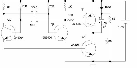

Well the biggest advantage of the LM3909 is the fact that it would flash LED's from a 1.5 volt battery. Unfortunately the 555 isn't specified to work on that low of voltage.
The closest thing are the flashing LED's, but they won't work on 1.5 volts either.
If you look at the internal schematic of the LM3909 is has about 4 transistors plus a diode in the package.
I developed a flasher that works on 1.5 V that uses 4 transistors.
The schematic is attached.
I occasionally see LM3909's on EBAY, but the price is generally pretty
high.

Your resolution is 555 SMT's @ 20 cents each with a schematic.
