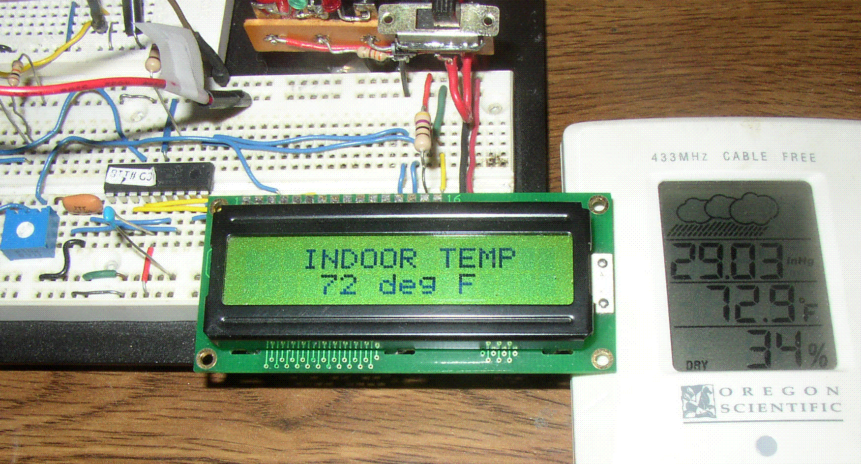

Attached is my effort at documenting the rising?? world temperature, LOL.
I may re-program to reflect the tenths portion, but the accuracy, as measured by the Oregon Scientific temp-hygrometer shown, is pretty good. Tested with a hair-dryer to 101 degrees, and consistently measured mid 50's in an unheated garage yesterday.
