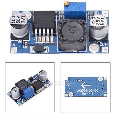

Maybe your 12V is actually 13V and the output of the LM317= 5V then it heats with (13V-5V) x 0.6A= 4.8W. You need a heatsink with fins (not a little plate) and some thermal grease.
Or better still, use a switch-mode regulator, you're wasting a LOT of your solar panel power making the LM317 hot.
You can get incredibly cheap switch-mode regulator modules, which will run MUCH cooler and waste very little energy.
Get a stack of something like this, about $1 each. Handles 2 amps with 3 amp surge.
Only a tiny fraction of the heat made by LM317 because it uses smps instead of simply converting excess power to heat.
just turn the little pot screw to dial in the voltage you need.
many other ebay site sell it. Look for model number HW-411 (it's made by some Chinese shop but many ebay stores sell it).
