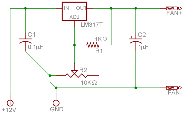

I have an CFL emergency light which works on 6v, and i only have a 12v 7.2ah battery around. So i found this circuit to regulate the voltage from 12 to 7.
I thought i can use it for other devices which runs on 3v and 5v.
I made it exactly as the schematic below but the output voltages are not like they should be.
When i connect it with my 12v battery , max output voltage is 4.4v.
When connected to 12v ac adapter(voltage is non regulated so on mm shows 18v) max output is 4.4v sometimes 4.5v.
When connected with 12v 2.5A power supply it max output is 4.5v.
I want it to regulate voltage from zero to the max voltage provided by power source. For example if power source is 24v then it should regulate from 0 to 24v using pot.
Currently using 10k pot, do i need to change that?
Regards!!!
My mistake, found out LM317 has different pinouts, i thought it would be same as 780x IC's. Will fix this tomorrow and update as i am out of solder wire for now.
To get down to 0 volts output, you'll need to find a -1.2v supply from somewhere to connect to the pot as the 317 will only regulate down to +1.2v minimum otherwise.
The 10K pot makes it such that you will be using only a small part of the rotation. Use a 2K pot if you have one. When you get it rewired and running, feel the tab on the LM317 (you are using a TO220 package?). If it burns your finger, then it is too hot and is going into thermal shutdown, reducing the output voltage. If that happens, you will need a heatsink.
The issue was i mistook its pinouts, i thought it would be same as like 780x. Rewired and now its working like it should be. And yeah it was damn hot when i tried running my cfl circuit using 7.5v, i have a decent heatsink installed, i hope its enough, else gonna have to put even bigger one.
For now 10k pot is alright, if needed i will change in future, or when i build another one.
The LM317 has a minimum output of about 1.2V and a maximum output of about 3V less than the supply voltage.

The resistor from the output to the ADJ pin on an LM317 is supposed to be 120 ohms so that the supply voltage does not rise when its load current is low (and destroy the low current Cmos circuit you might try powering). Then the value of the pot needs to be recalculated. Many circuits wrongly show 240 ohms for the resistor because the datasheet has many examples of circuits for the more expensive LM117 that can use 240 ohms.

The load current is not the only issue, but lets start with that.
If the load is 10ma then there is less to worry about. But you do have to make sure that your load is always 10ma. That means if you can adjust down to 5v for example then the load must be a max of 5/0.010 or 500 ohms. That actually is something we might typically see too. But that's not always the case because the voltage might be adjustable down to 2v, and then we need a much smaller resistor.
So it is usually recommended that 120 ohms is used between output and adjust terminal and that takes care of that as well as another issue.
The second issue is the temperature sensitivity of the bias current.
The bias current is part of what sets the output voltage even though it is usually ignored. It flows through the lower resistor and therefore it raises the output voltage somewhat over the normal voltage ratio calculation set point.
The problem is, the sensitivity of the output voltage is dependent on the ratio of the bias current to the normal set current through the lower resistor. If the bias current is small relative to the current through the 'feedback' resistor (like 120 ohms) then the temperature sensitivity is at a minimum. But if the bias current is larger then the temperature sensitivity goes up meaning the output will change more with temperature than is normal for a proper design.
With 120 ohm resistor the feedback current is going to be 10ma. That means the bias current is 200 times lower than the normal current, or about 0.5 percent. With a resistor of 1200 ohms, the feedback current is about 1ma, so the bias current is only 20 times the normal current, or about 5 percent.
So the difference between using a 120 ohm and 1200 ohm resistor (with appropriate load current) is the temperature sensitivity is increased by about 10 times, which basically bites. If that does not bother your application then you're ok, but if may bother it if it changes temperature by any reasonable amount.
So the 120 ohm resistor solves two potential problems.
