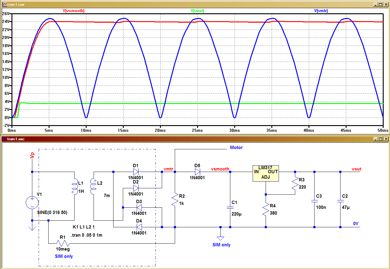

hi Bill,
Just drawing a circuit, few minutes...
EDIT:
Look at this option.
Its with the motor at full speed ie:12V
I need to see your circuit for reversing and then I will complete a drawing.

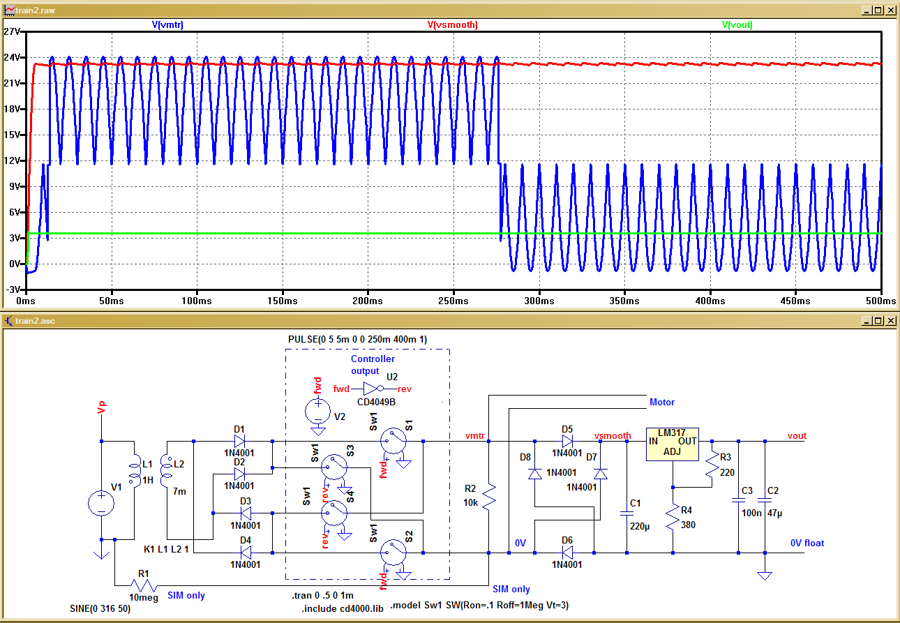

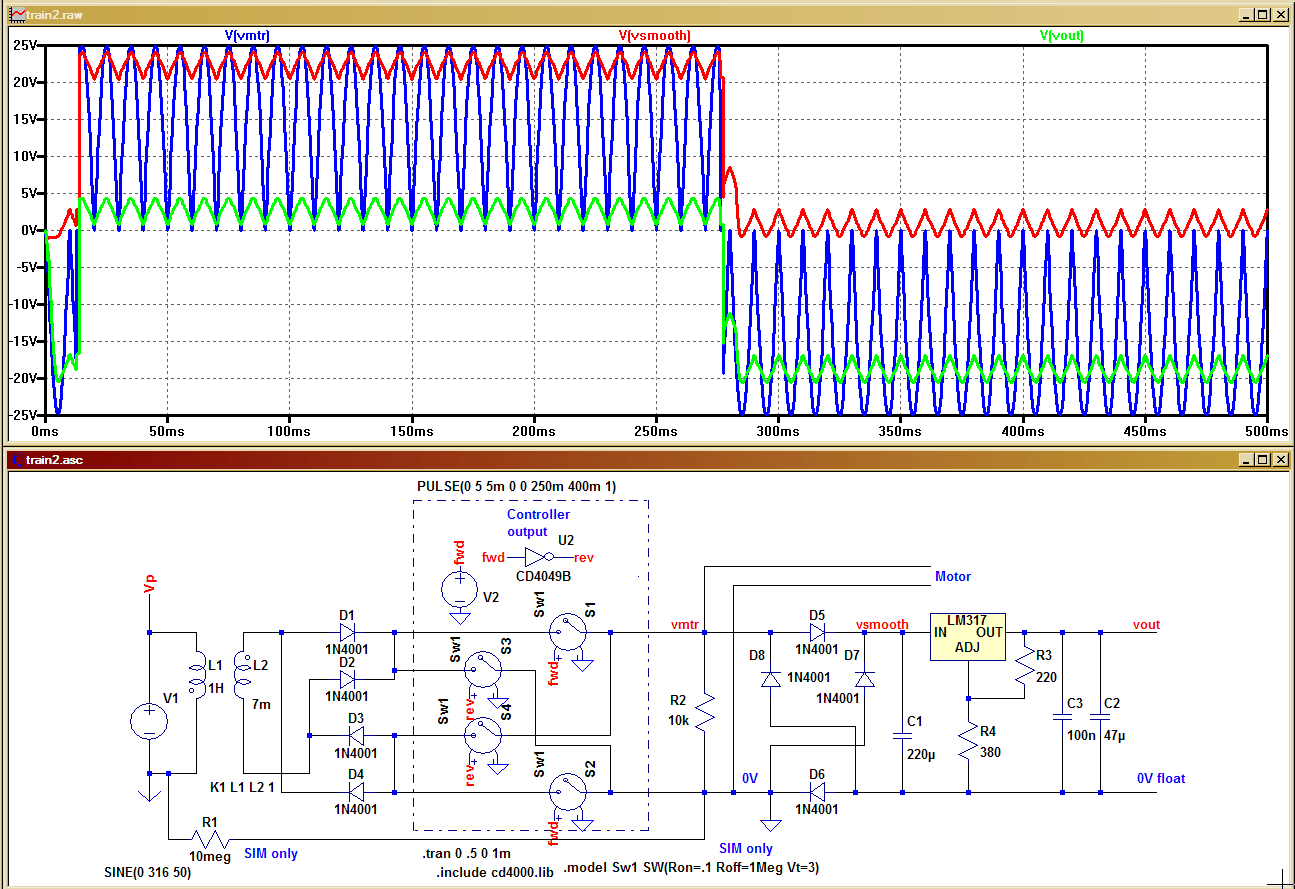

hi Bill,
This circuit shows a full wave rectifier for the LM317 connected across the motor drive, for a full speed condition.
Gif1 shows the 3.5V using the 3.5V output as reference, NOTE: the 3.5V ground 0V, will be above the motor ground.
You cannot connect the LM317 0V, to the Motor Controller 0V
Gif2 shows the 3.5V with the motor 0V as reference.
The circuit inside the rectangular box is simulating the controller fwd/rev.
If your circuit uses the back EMF from the motor, the LM317 smoothing cap could load the back EMF, its a point to watch out for.
Also the input voltage to the LM317 will have two diode voltage drops, ~1.4V.
So this 1.4V should be added to the 1.5V low current drop out voltage of the LM317. so for 3.5Vout you will need ~6.5Vinp.
Can you explain that to me please? The bridge is the only means of isolating the LM317 from the Motor Controller 0v( sort of). Is this not exceptable? I would also be very gratefull if you could explain reasons for R1 (10meg) and R 2 (10k). Essentially I believe I am looking at the circuit from the bridge D5 -D8 onwards.
Again thanks and regards,
Bill
Bill,
Due to the full wave bridge, the output of the LM317 will not be directly connected to the 0V of the controller, you have the diode voltage drops to consider.
If you did directly connect the LM317, 0V and Controller 0V, you would effectively short out part of the diode bridge.
The R1 and R2 are just for the Simulation in LTspice.
The transformer and bridge are only to provide a test wave form for the Sim
and the switches so that I can show the effect of forward and reverse.
