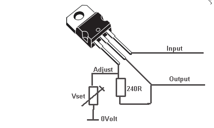

hi Mark,
Look at this image for the connections.
Add the required decoupling capacitors on the input and output.

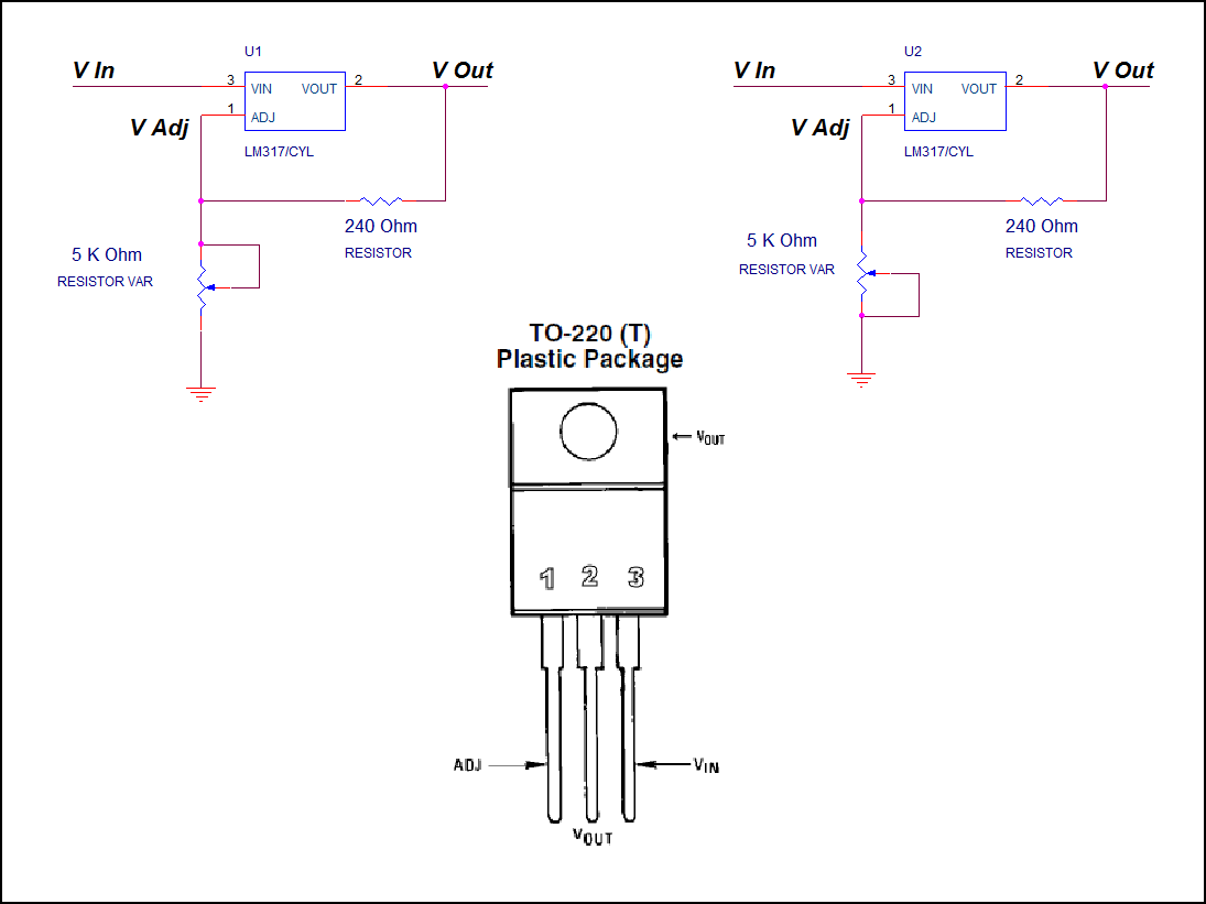

The circuit you have should resemble the attached. The 5 K pot can be configured a few ways as can be seen. So Max is a matter of how it is wired. The only way a pot like this will actually burn up or cook is if there is excessive current through it. Also note in the LM317 pin out image that the tab is also Vout so if anything is on the tab like a heat sink it is at Vout potential. The attached is sans caps as I doubt a cap is the problem with your symptoms.

What output voltage do you have? With the pot set close to max (i.e.the wiper shunts most of it) the 240 ohm resistor will pass ~4mA per volt of output. So at 25V output, say, the pot current will be ~ 100mA. As that is going through a tiny part of the resistance track it may well be enough to cook it, especially if the pot is a miniature type. Could you make the resistor, say, 1k? (That would, of course, reduce the adjustment range the pot provides).

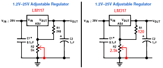

Only "typical and better" LM317 ICs need a current of 5mA. Weak but passing ones need 10mA provided by changing the 240 ohm resistor (used for an expensive LM117) to 120 ohms and cutting the value of the pot in half.
The datasheet does not show the correct schematic for the voltage-setting pot. You probably connected it so it shorts the output. My schematic is correct.
ALL circuits in the datasheet (and all over the internet) show the 240 ohm resistor used with the more expensive LM117. If 240 ohms is used with a weak but passing LM317 then its output voltage rises without a load (no regulation) as explained in the datasheet.

The 240 ohm resistor for an LM117 has 1.25V across it. Then its current is 1.25/240= 5.2mA.
The 120 ohm resistor for an LM317 also has 1.25V across it. Then Ohm's Law says its current is 10.4mA.
The amount of power in the resistors is almost nothing.
If the pot is set to a very low resistance then the output voltage of the regulator will be close to only 1.25V (the lowest output voltage of an LM317) so the resistors will not get warm.
