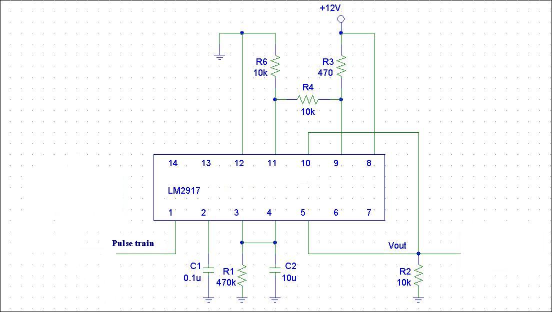

Hey,
I am trying to convert a 10-30 Hz pulse train (varying between 0 and 10V) to voltage with a LM2917N circuit (see attached scheme). I have two problems;
1. The output voltage isn't right according to the values of C1 and R1. For example, a 12 Hz pulse train yields 3.3V output, 18 Hz yields 5.2V and so on.
2. The output voltage is "capped" at 6 Volt, I'm unable to get it to increase beyond this value no matter what voltage I feed the circuit with or what values I use on the components.
While 1) is mostly annoying and can be fixed by simply changing the value of R1 I would still like it to work according to the formula in the data sheet (Vout = Vsource * frequency * R1 * C1).
Problem 2) is worse though and I can't seem to find a solution. Can it have anything to do with the built-in zener diode? It is also strange that it is capped at 6V no matter if I use 12, 15 or 18V to feed the LM2917.
If anyone could shed some light on this I would appriciate it deeply :)

The zener voltage is your Vsource (VCC). According to the datasheet, this should be 7.56V (typical), and there is no tolerance specified. Note 3 is also relevant:
Note 3: VOH is equal to 3⁄4 x VCC − 1 VBE, VOL is equal to 1⁄4 x VCC − 1 VBE therefore VOH − VOL = VCC/2. The difference, VOH − VOL, and the mirror gain, I2/I3,
are the two factors that cause the tachometer gain constant to vary from 1.0.
1VBE is approximately 0.7V. I am surprised you are getting 6V out for VOH.
Huge thanks, now it makes sense. All calculations match (well enough at least) when using 7.56V as Vcc.

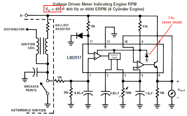

Isn't VOH the voltage on pin 2? The only reason I can see for the Vout cap at 6V would be if it is somehow related to Input Common-Mode Voltage on the OP AMP/Comparator which is listed as Vcc-1.5V Max.
Your circuit is nearly the same as the tachometer in the datasheet.
The output opamp is powered from the 7.6V zener diode and its max output voltage is about 6.7V.
The output emitter-follower transistor has a base-emitter voltage drop of 0.7V so the max output voltage of the circuit is +6.0V.
Hi AG, how do you know the max output of the op amp is 6.7V? I was just going by the note in the datasheet:
. Thsi equation results in VOH~5V.:confused: Maybe the datasheet is being conservative?
Roff said:
Hi AG, how do you know the max output of the op amp is 6.7V? I was just going by the note in the datasheet: . Thsi equation results in VOH~5V.:confused: Maybe the datasheet is being conservative?
The output of the opamp is a single transistor emitter-follower, not a darlington like real opamps. So its output high is about 0.9V below the supply, not a percentage.
