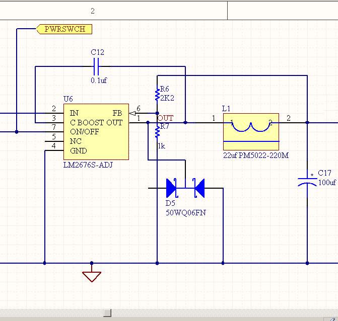

Hi all,
I have a power supply problem, I am powering a GM862 with a LM2676 but it fails to power up correctly, I am pretty sure this is due to the ripple (logged at >700mv) from the regulator can anyone look at my design and advise how I can improve it to reduce this ripple so it works reliably across 8v-40v and max 2.5A
Input voltage = 8v-38v
Output Voltage = 3.8v
IOut Max = 2.5A

I've tried the Webench, and give same value (22uH,100uF), but i always use 47..100uH (what i found...) and 470uF without any problem. Sometimes need an additional filter for fussy circuits.
Anyway the GM-47 engine need 2200uF capacitor nearby the socket...
