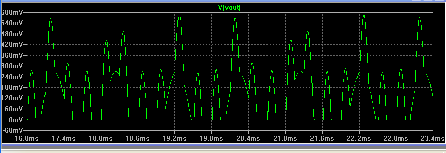

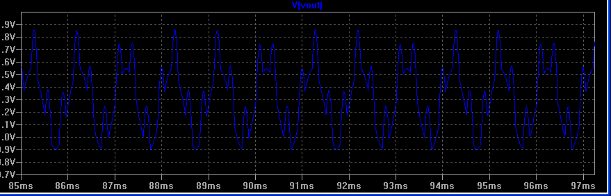

Here you go.
It will not mix sign waves at ground. I hade to insert audio offset upward by 2.5 volts to get the amp to work. Other wise only the top half of the audio came through.

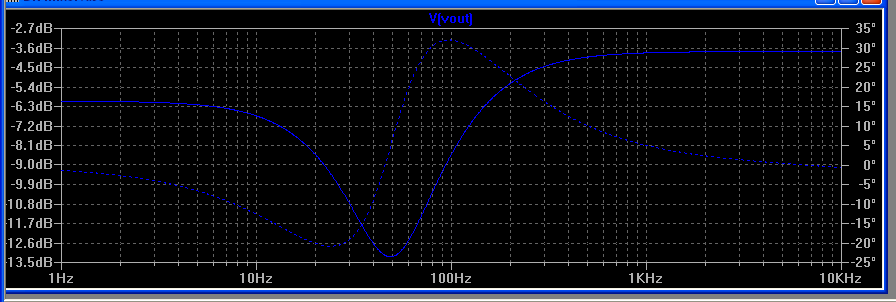

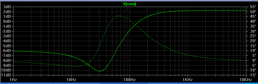

Here is the frequency response. The DC and AC are not the same gain by 8db. With that 1" speaker you can't hear 100hz so it does not matter. Could have been built with less parts.
It has an audio out jack, so you could hook it up to some good speakers, maybe thats why all the extra parts.
I had a resistor value wrong. -6db and -3db.

Output of two sign wave sources at ground. 1khz and 3333hz

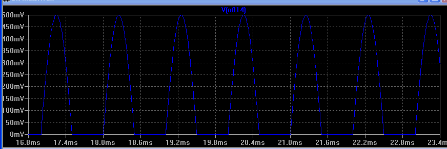

Output of the first buffer. Only 1/2 the signal is buffered. The other 1/2 is lost.
