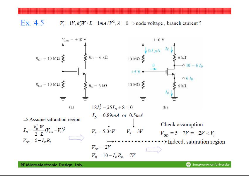

Hello people! I'm Francesco from Rome, Italy. I'm trying to learn electronics. I'm stuck on exercise... I don't understand a stupid thing.
I've posted the exercise...
My italian edition of sedra smith, says that because of the Vg=+5V
the mosfet is certainly ON. We only have to understand if it is in triode or saturation region.
My question is: How we can say it is ON!?!?
We know that Vg=+5V but we don't if Vgs>Vt ...! Please, help me :)

Hm..i believe its actually just an educated guess.
Most of the times when dealing with diodes and mosfets, you have to guess and then work out the math to see if you are right.
Vds < vgs - vt for triode
vds > vgs - vt for saturation { both of these requice vgs > vt}
and vgs < vt for cutoff
Since the gate voltage is 5V and Rs goes to ground, you can 'guess' that Vgs > vt, so it it should be triode or saturation. If the math does not work out, then that leaves cutoff.

The source resistor is the same as the drain resistor. So the gate-to source voltage is divided twice to only 2.5V. Even though the Mosfet current is very low at 833uA many Mosfets need a gate to source voltage of 4V (the threshold voltage) to conduct only 250uA.
Look at the spec's for the Mosfet in its datasheet.
