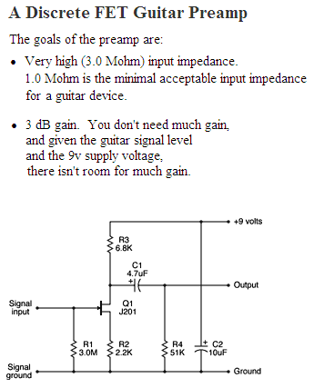

Here is what a guitar electronics geek says about the input impedance of a guitar's amplifier:

That looks like something I can build, Audioguru! :) I just read an article about input impedance as well..
Now, remember....I'm just a goofy girl in Tucson teaching myself electronics so please don't get frustrated at simple questions...heh..but here goes:
I could build that circuit you just posted and use it as a preamp for the Little Gem, right? LOL!
Then it is almost the same circuit as The Ruby. Make The Ruby instead. It has a proper volume control.
