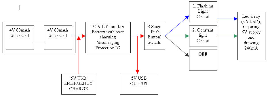

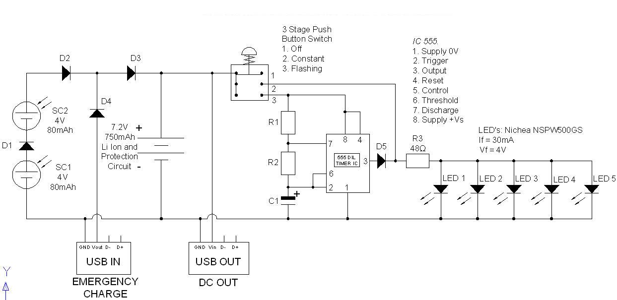

Hi Everyone
I am working on an Electronics Design for a Solar Torch for a University Project.
However, my knowledge of electonics is quite weak and I don't quite know if what I have designed is actually practical....
Could you have a look at the attached Circuit Diagram and give me your opinion? I have also attached a flow chart which gives a rough idea of what I am trying to achieve.
Any critisism or alternative suggestions will be very much appreciated!!!
Kind Regards
Matt
Hello again
I have just posted another thread with respect to my design so far, but will put it up here for your information....
Attached is a Flow Diagram of what I am trying to achieve and the circuit schematic so far.
Any critisism or alternative suggestions will be very much appreciated as to be honest I have no idea if it can practically work!!
PLEASE BE GENTLE!!
Kind Regards
Matt

Solar panels are rated at noon in the Sahara Desert. The sun is directly overhead in the Sahara destert and then the current will be 80mA if the solar panel points directly at the sun.
Elsewhere on earth and at different times the current is less.
Two lithium-ion cells need a total voltage of 8.4V to reach full charge. Your 8V solar cells have three series diodes reducing their max voltage to only 5.9V.
The 5V from the USB input has one diode that reduces its voltage to only 4.3V which is much too low to charge two lithium cells in series.
You are wasting too much energy in R3. It is OK but a real torch would not do that.
Will a 555 drive 5x30mA=150mA?
USB in/out: 5 volts will not charge 7.2 volts and 7.2 should not go to USB out.
It is not a good idea to parallel LEDs. For a school project…OK but in production you will find that the LEDs will not share the current equally. For example my red LEDs have a voltage drop of 1.7 min. 2.0 typically and 2.2 max. If a 1.7 and a 2.2 are parallel then one gets very hot and the other is very dim. In production we sort the LEDs so all the 2.0 are together and all the 2.1 are together.
An ordinary 555 can sink or source up to 200mA. Its output voltage loss with a 150mA load is typically 2.1V so when the battery is 7.2V the output voltage of the 555 is 5.1V and the total current in the LEDs is only 23mA.
If D5 is there the there is hardly any voltage for the LEDs but without D5 then the voltage across R3 is 1.1V and the total current in the LEDs is only 23mA. Then the output voltage of the 555 will be a little higher so the LED total current will also be a little higher. Very dim LEDs.
