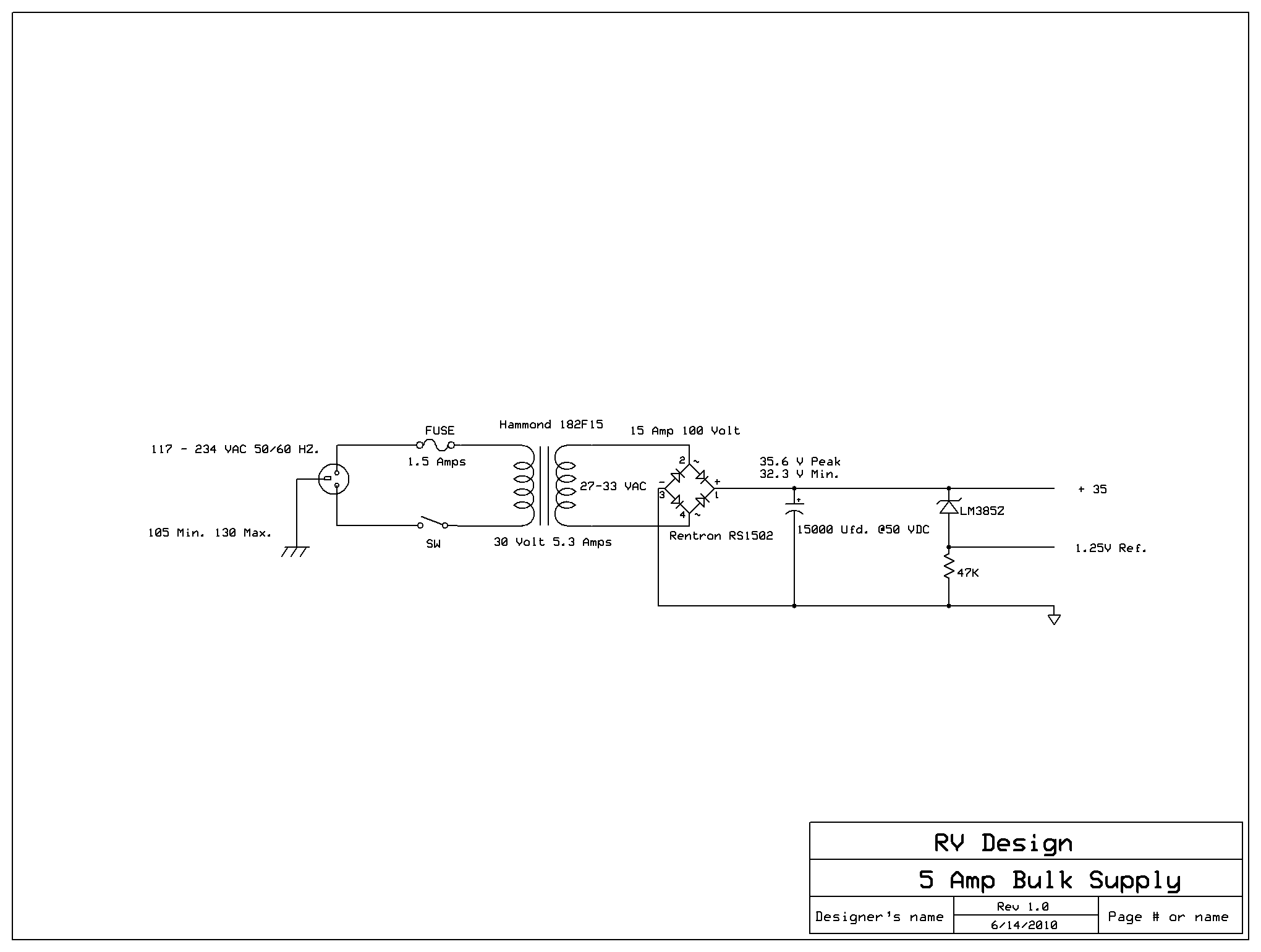

I am not the best circuit designer, but as we go along we can have people here review the design. I would suggest that we work off line by e-mail then post once in a while if that is ok with you. We can also build in stages. 1- Transformer, bridge, and filter. 2- Basic voltage regulator. 3- Current limit. 4- High current (more transistors). Let me know by e-mail if this is ok. Ronv@wbhsi.net

Attached is the first step for our supply. The transformer is pretty expensive ($75 US). We can look around for a cheaper one. The parts datasheets can be seen on this web site: Electronic Components & Supplies
Let me know what you think so far.
Ron V.
