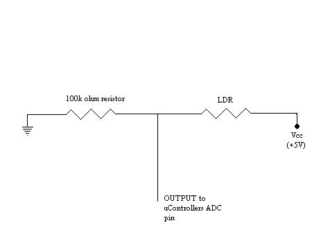

actually i'm kinda confise abut the circuit for the sensor.....
can you post picture of circuit for sensor in line follower robot ???
you position both facing the ground. so the LED light mirrors/bounces from the ground and more light mirrors from withe and less from black
here's the schematic:
what schematic would you use then? this schematic is working for me and i don't see why i whould use another one. only thing is that LDR's must be exactly the same.
