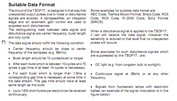

The TSOP requires a pulsed emitter pattern for correct operation, not on/off IR line detection. datasheet.

yeah, i know it ......................
i have applied 38khz pulses(square wave).........

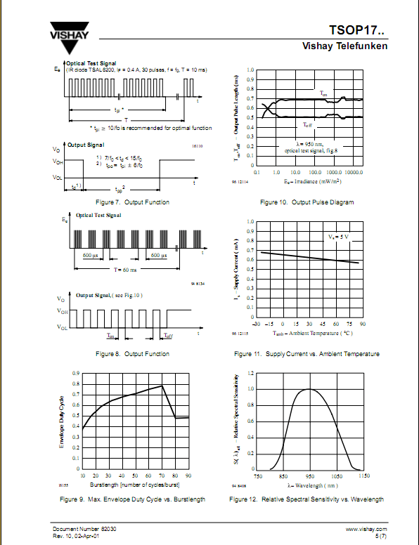

Are the pulses of the emitter produced to this specification.? 10 to 70 pulses and a gap of 14 pulse periods.?
A continuous 38KHz pulse rate will not work, look carefully at this image
I am not getting what is the BURST LENTH??????????/
Its the number of pulses in the 10 to 70 pulses, if you know the period of the pulses you can work out the Burst length [period]
Note what it says about a continuous 38KHz signal, in the 'errors' section.
