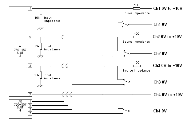

What i want to do is make a test unit so i can source 0-10V and then monitor the output. The problem is that when the system is off, there will be a direct short between the pos and neg on the power supply. (through the relay). I don't want to burn my relays up so thats why i wanted the limit the current. The AI have high input resistance so i don't need to do anything for those. I can just connect the psu right up.

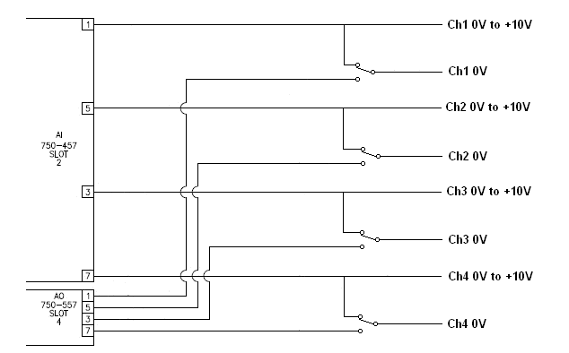

Anyway, I've replaced the capacitor symbols with switch contacts and removed all superfluous information such as terminal blocks and wire numbers. This information might help when assembling or testing it but it's just distracting when trying to figure out how it works. All I need to know is what's connected to what, the wire number, terminal block isn't important at the moment.
Are the four 0 to +10V channels going to be connected together for the purposes of the test?
If so, we might as well draw them as one power supply for now otherwise they'll have to stay separate.

Is my schematic right?
It does seem odd that you're switching the negative rail or have I got that wrong?

Ok first of all, i prefer your schematic over the one our guys developed. I know theirs is necessary for wiring it up but yours just cuts to the heart of it and lets you know whats going on.
These 10V channels are used as a reference for speed control. Under normal operations it is a simple 10V circuit with a pot used to adjust the voltage and in turn, control the motor speed. We come in and tie in series with that signal. As you can see on your diagram, when our system is off, the signal is just looped right back out to them. We are monitoring it so out outputs are already at the correct voltage in case they switch our system on. Once you turn on our system, instead of looping right back to them, the signal is now sourced from our analog output cards. (Based on the input we are still receiving)
What i want to do is connect a 0-10V source into the system so i can send different voltages to the analog cards and then meter the outputs to make sure they are changing. I would like to be able to turn our system on and off so i loop that power right back and make sure all my relay contacts are good?

Don't forget, I can't see the rest of the system. So far I understand that it's a four channel motor controller with the speed controlled by 0 to 10V inputs.
What do the different slots actually do?
With the system drawn above, with the relays in the unpowered state, all the 0 to 10V voltage sources will be shorted to 0V. The inputs to slot 4 will be floating which might lead to instability if they're high impedance and don't have internal pull-down resistors.
When the relays are activated, the 0 to 10V sources will be connected to slot 2 and slot 4 will be connected to 0V.
I'm not sure you understood me before when I talked about input impedance.
Each input will have a resistance which takes a tiny electrical current.
The 0 to 10V outputs will also have a source impedance.
In the schematic below, I've drawn the impedances on the schematic for the first three channels of slot 2 and the 0 to 10V voltages, I've assumed 10k and 100R respectively but it'll probably be much different. As the 0 to 10V sources are pots, the impedance will depend on the value and the wiper position, it will be very low when the wiper is set to either the maximum or minimum settings and highest when it's in the middle.
If the 0 to 10V channels already have a high enough impedance not to draw to higher current, then they can just be short circuited without any problems. If the impedances are low, short circuiting any of them will cause a high current to flow which will cause overheating.
If the input impedances as high and the inputs can't be short circuited, then you can limit the current by putting a resistor in series with the 0 to 10V voltage sources. Of course the resistor will need to be low compared to the input impedance but still high enough to prevent too higher current from flowing. For example if the input impedances are 100k then you could add a 470R resistor which will have negligible voltage drop.

The analog input has an input impedance of 100K ohms. So that means my current is 1mA@10V and less than that at lower voltages?

No, the current will be 100µA@10V but yes, it will be lower at lower voltages.
Just add a 470R resistor in series with the 0 to 10V signal.
I've edited my previous schematic to show what I meant by input/source impedance. I know you know now, but I had already prepared it so it might help those who don't know.
