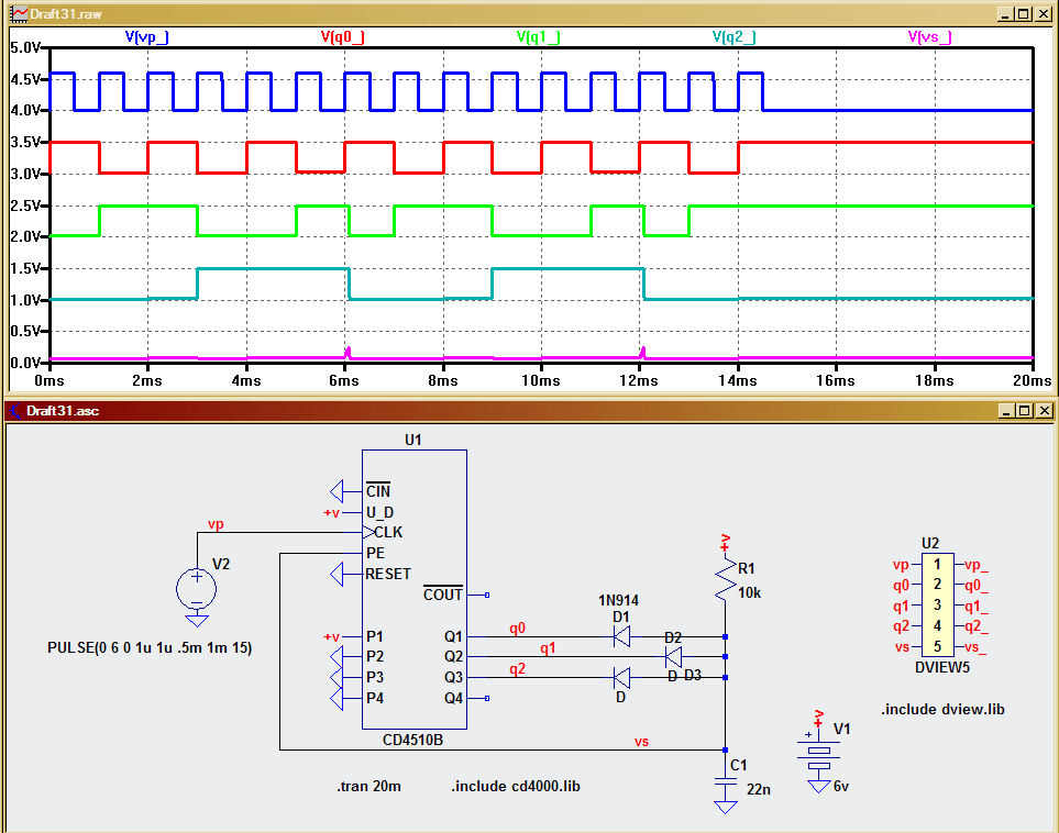

Hi everyone, new here so sorry if this is a noobish question :) (Tried using search but didn't find anything that was done with the same ICs).
For the clock I'm using a NE555 IC that is connected to a 4510 BCD counter which is connected to a 4511 that drives the 7-segment display.
So the problem is that I don't know how to change the '0' to '6' on the 4510 counter.

So anyone wiser than me care to tell how I can change the 000 to 110
and how to reset the chip so that it won't count to 6 (110).
So basically it counts to 0-5 and converts the 0 to 6.
If there's an easier way to do this please tell, this is just something I came up with.

You need to detect the 7's count ie: 111.
You could use a 3 input AND gate for the 7 detect and use its output to reset the 4510, or diodes and a resistor. OK.?

As you dont want '0', use the 7's pulse to P/L the count of '1' intothe 4510

Hmm, but then how should I do the skip from 0 to 1, because with that setup it would count from 0-6 and I'd like 1-6 like a regular dice :)

Can you follow this circuit OK.
You need the 3 diodes, a 10k and 10nF or 22nF cap.
Connect the parallel inputs as shown so that a '1' is loaded.
