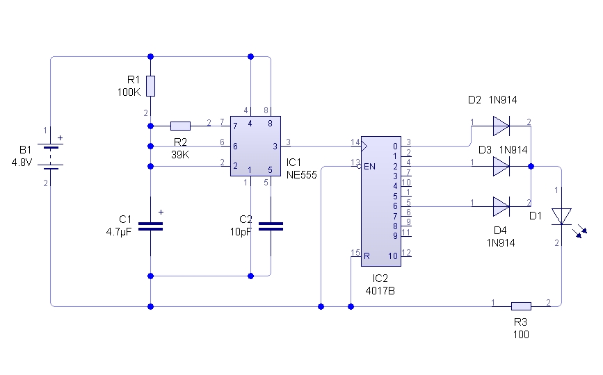

How about a 555 to clock a cd4017. You would have 10 outputs to choose your flash/pause pattern from. I think a 4017 needs around 3 volts. All the garden lights I have are 2 cells, or 2.4 volts. I replaced the batteries on one with a 3 cell pack 3.6 volts, works fine. Even replaced the amber LED with a flashing RGB LED, but after about 2 hours, it just flashes red.
I'd stick with the amber LED for you lighthouse, white LEDs are around 3 volts, they'll work, but not very long before the batteries are drained.
Never tied the outputs together on a CMOS chip, so not sure if that's allowed, might need blocking diodes.
Personally, I would stick to the garden light's charging/switching circuit. I built two different designs, but work about the same. When it starts getting dark, it slowly switches in the load. Wastes battery power. If find a circuit that switches between charge/load quick and clean, will post it. Had an idea once about using a voltage reference of the solar panel, and just getting rid of the Cds sensor, but couldn't find the part I was looking for.
A 74HC4017 is guaranteed to work down to a 2.0V supply. You can't short outputs together but series diodes can be connected together to make patterns of flashing. Then the diodes drive the base of a transistor through a resistor to turn on the LED. Use a Cmos 555 as its oscillator and the original batteries and charger.
Here's a quick circuit on LiveWire. For longer delays between flash might cascade a second 4017 off the Carry. I don't have models for the low voltage versions of the 555 or 4017, this was just illistrate the function. The pin-outs are most likely the same.
Cheers.. Thanks for that. Must allocate Livewire to my computer at work and see how things progress.
