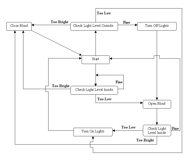

Ive drawn up a flowchart of what i think i what i want, if you can see any errors please inform me

i am afriad that i have had no luck at all for schematics but i would like to point out that the light sensors outside may be affected by the lights inside the greenhouse.

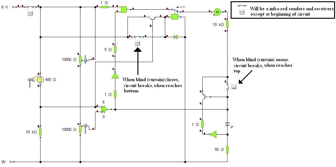

Finally after 6 hours of sitting down and getting it done, i have drawn it up, and it works on the software anyway!! I figured that i wouldnt have a light sensor inside, like monkeytree said, it all gets complicated, but this should work nicely. I thought i should put this on so that if anyoen else was thinking of making a greenhouse.....you never know. This could be used as a base plan. Man am i glad to have finished designing that now. phew.

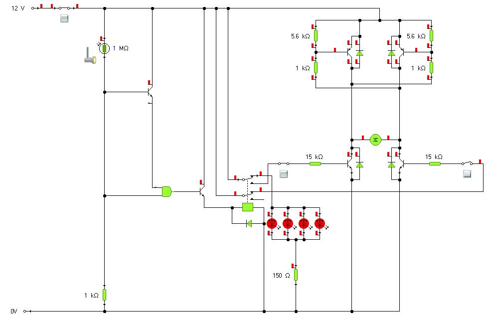

I know you lot are probably tired of seeing this topic, but i talked with my teacher and he said bluntly, that wont work, he said mainly because it uses logic gates to run a motor, and thats a no no according to him. So of course with that, i had to make a new circuit, which works just as well, if not better, so im happy, the only thing is, now my teacher is winning the on going battle between me and him, so i must try and get him to be wrong soon, mwhaha. Well here we are, the circuit, the on/off switches are the same as labelled in the diagram above. If there are any blantent mistakes, dont hesitate to tell me!!
