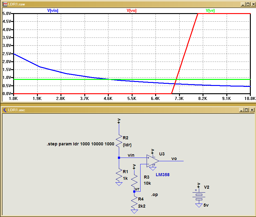

I'm attempting to simulate the top part of the following circuit:
Here is my PSPICE circuit at 3 different LDR resistance values. Somehow I need to adjust the circuit to allow the output of the op amp to go high when the LDR resistance value is changed, such as when different amounts of light are shining on it.
No matter what I do the output remains 0 (approximately).
I'm sure my circuit layout isn't correct but if someone could offer any insight I would greatly appreciate it. Thanks!
You are using the opamp as a comparator; bad practice. However, beit an opamp or a comparctor, it switches when the two inputs are equal. You have 5V on the inverting input, while the non-inverting input always has a voltage smaller than 5V, so it will never switch. You must bias the inverting input by using a pot, so that the wiper can be set to any voltage between ~ 1V and 4V. You also need to provide some positive feedback to keep the comparator from oscillating back and forth as the two input come close to the same voltage.

The circuit will work only if you keep the input voltages within the Allowed Input Common-mode Voltage Range (shown on its datasheet) which is from 0V to 1.5V less than its positive supply voltage.
You have one input at the same voltage as the positive supply so the input transistor is completely turned off and it does nothing.
EDIT:
In addition, the output will go high only when the input voltages are within the allowed common-mode range and the (+) input voltage is higher than the (-) input voltage. Your circuit never has this happen.
Your simulation program is sick. It is impossible for the output to be a negative voltage since there is no negative supply.

Use the Spice .STEP PARAM function to vary the value of the LDR's resistance.
Here is a simple example stepping Resistor value.
There are LDR examples and formula available if you really want to be precise, often a simple stepped resistor will give you an idea of whats happening within your circuit.
