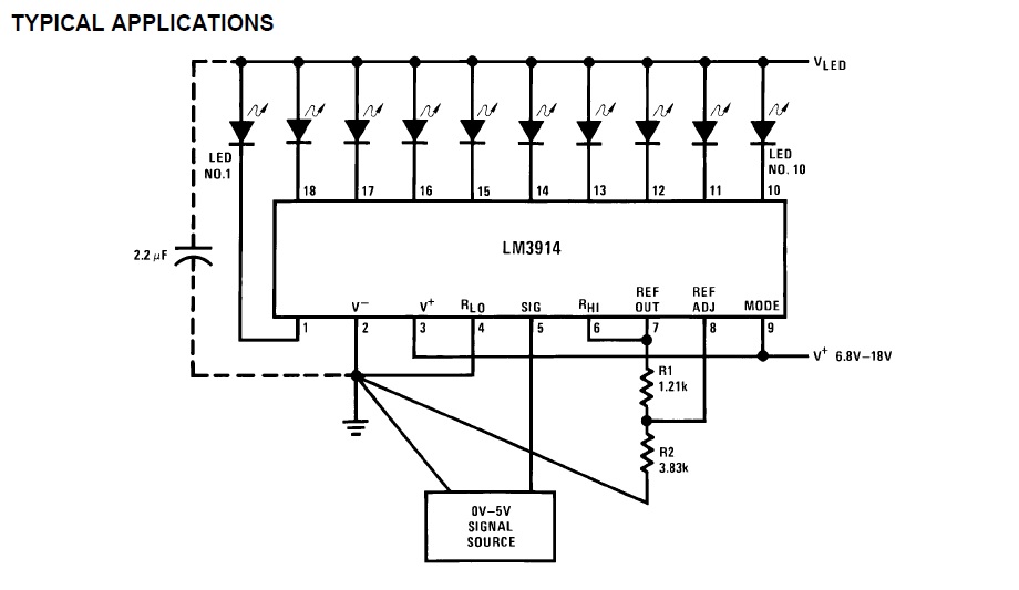

If you want to make a light meter (if the light meter is the priority not the circuit you posted), you can use easily LM3914 and a LDR.
