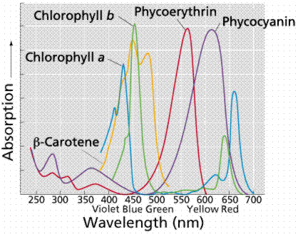

Plants have certain frequencies of light they require for vegetation and fruit/flowering. When growing indoors, the critical frequencies of sunlight must be reproduced. Traditionally this is achieved through broad spectrum lighting such known as High Intensity Discharge and achieved using metal halide type or high pressure sodium. These are VERY hot and power hungry. The new type of lighting is with LEDs. The problem with LEDs is that they are not an ideal match in terms of the frequency of light they emit.
For example, red LEDs are typically just above the range that plants like most, so the best lights are ones where you can evaluate a large sample of red LEDs and choose the ones closest to the target frequency for the light.
I would like to build a sensor that can evaluate a spectrum of light, or take individual frequency samples, to assess the effectiveness of the light and suitability for use as a growing light. You can see the attachment for a diagram of the light spectrum.

What you want is a colour sensor =) Photodiodes sound like they would work. You can pick their wavelength sensativity in a pretty wide range. Check out Digi-Key Corporation - USA Home Page and search for photodiode They sell 657 different kinds from 254nm's to 1300nm's
Note this is just the 'peak' wavelength, they'll pick up others so you'll probably want to use a filter over the sensor, filters for those specific frequencies may be hard to find. Take a look at Wikipedia's entry on photo diodes and look at the spec sheets for the diodes on Digikeys website and you should have a better clue of where to proceed. You may be able to google for photo diode circuits to get an idea of how people typically use them. With a good filter a photo diode should be pretty accurate.

Okay, I looked at some of the photodiodes and they provide the correct function I'm looking for (detecting frequency), but isn't the accuracy a problem?
The manufacturer publishes a datasheet showing the expected frequency of emitted light, and the photodiode manufacture also shows a datasheet of the expected response curves, but doesn't one of them have to be known to be accurate in order to make a valid test?
In practical terms it means that I see a red LED and it looks red, and my photodiode detector says it's red, but given the variance in each part there's no way to know if it's the actual 625 nm frequency I'm looking for.
Since the LEDs or other light sources will vary, at a minimum then I at least need to calibrate the detector with a known light source, or I need a detector that can be used to determine the frequency within some narrow range of error.
Preferably I would be able to sample the incoming light at a variety of fixed frequencies. Photodiodes could work if there were more available for different frequencies, then I could build a circuit with dozens spread out over the spectrum give more sample points.
The only other obvious solution is to use a physical interference filter with know specs to ensure only light of a certain frequency is passing through.

You pretty much have it nailed there bibb, it's not easy, not if you want that precises a measure of specific wavelengths. Diode's + filters would be required and filters would be expensive and difficult if not impossible to find or construct for such a narrow bandwidth. You could look into commercial optical spectrometers but the price would probably kill you.
I just thought, for calibration you can use LED's they are a narrow if not mono chromatic light source (excluding white LED's) And measuring a 'white' light source (the sun) you can get a feel for the responce curve of the various photo diode's you're using.

I thought I'd add the little insight that I have acquired. The light spectrum between 400-700nm is what is referred to as Photosynthetic Active Radiation (PAR) or Photosynthetic Photon Flux (PPF). It is, as you might suspect, the wavelength of light that plants require for photosynthesis.
The key with measuring this narrow band of wavelength is having the proper photodiode and even more importantly the proper filter on the sensor head. There are a handful of vendors of PAR/PPF sensors out there, **broken link removed**is one **broken link removed** is another. Depending on your point of view, the price really isn't all that bad (at least for Apogee) considering the accuracy of the measurement that you get in return. Of course, if you wanted a dozen of these, then you'd really start to feel the pain.
Several years back the B.C. Ministry of Forest required a quantity of these sensors for their research. They decided to roll their own to keep their budget reasonable and were generous enough to publish the results. They experimented with various photodiodes and were able to obtain decent results in the process.
I hope to use this document as a guide in building my own sensors at some point down the road when I have the time, meanwhile I purchased one from Apogee to get me up and running and to use as a "standard" for comparison purposes when I do get around to taking a shot at building these from scratch.
