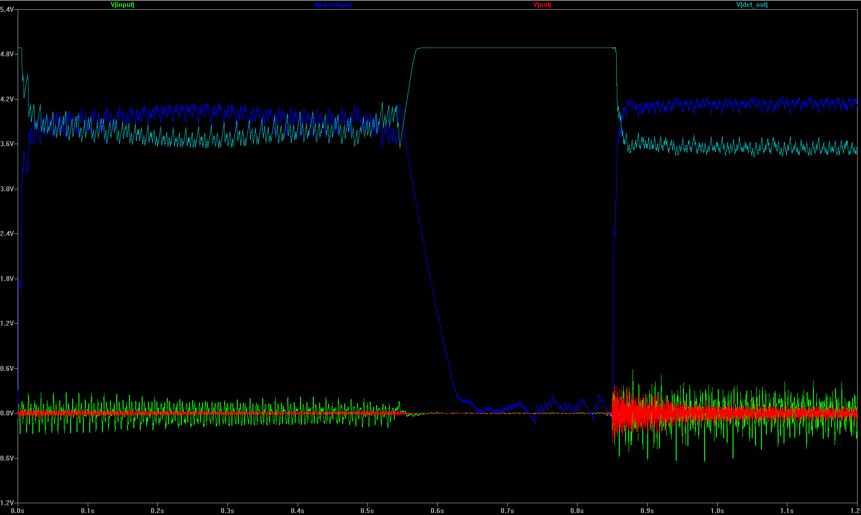

Anyways - here's a waveform I got without using LDRs (attached). I hooked it up to a band pass filter on the output. The sound really doesn't change that much, so there's still something missing. The det_out is the voltage that controls the LDRs.
Edit: I'll go the FET route if I have to I guess. :)

Cool! Yeah, the original document even mentions the "mystery LDR" so it might be hard to find. Normally I just cheat and test a few from a Radio Shack grab bag, find one that's fairly close to what I want, and rejigger things to work with it.

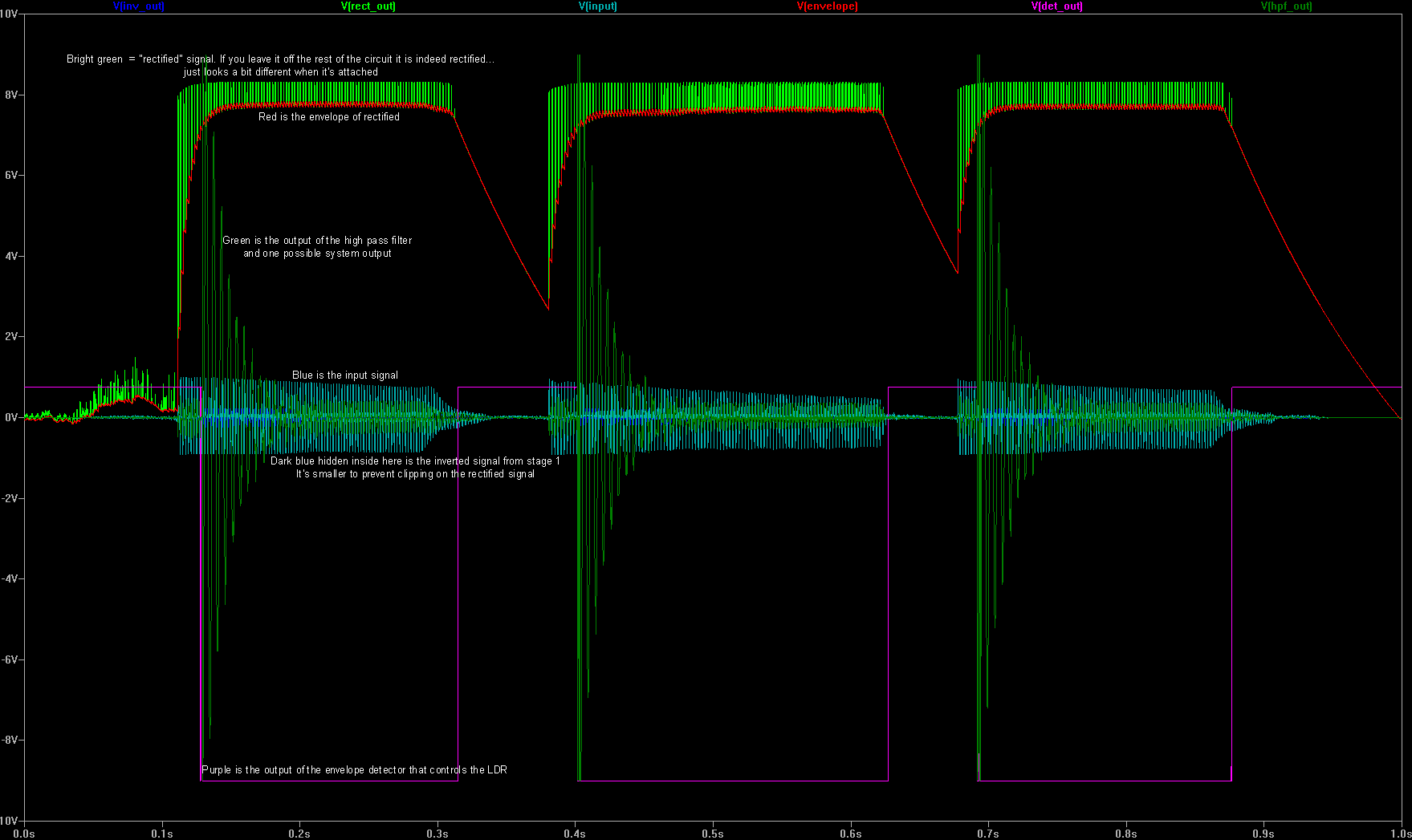

Looks like I had some small issues with my circuit before - I think I've ironed most of them out.
I originally thought the control for the LDRs was a very much varying signal based on the envelope. If I've done things right, it's actually more like a digital signal (except from about 1V to -9V or from 1V to 9V, depending on whether you want a "wah" or an "ow").
I attached both the waveform and my circuit to this post. I think I'm still just having problems with the silly resistors. What do you guys recommend. I'm just trying to use the varistor part in LTSpice - did I hook them up wrong?
