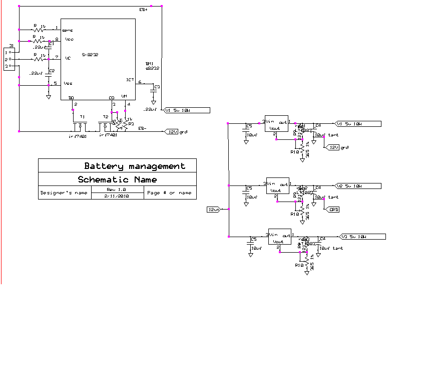

am assuming this is correct? using a battery management IC S-8232.
the batteries are 9000mAH battery pack.
never worked using such an IC.
any suggestions

Sorry, not correct. The LiPO batteries are supposed to be at the far left of your diagram instead of those two capacitors.
Re-check Figure 8 on page 18 of the data sheet.

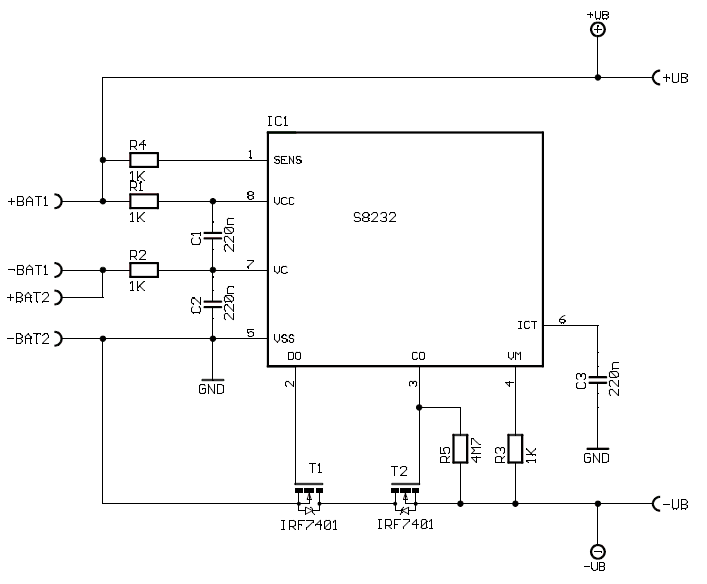

Hi MrDEB,
the chip is a LI-ION charger, no LIPO charger.
However I made a PCB design for it. Board dimensions are 0.98X0.8".
If you like it PM me your email address. I'll provide the Eagle files for it.
The power supply can't be dual (symmetric). There are just two connections for external power. EB+ stands for the positive rail and EB- stands for ground.
Just don't connect C3 and VSS to the negative rail of the power supply.

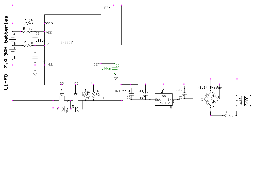

Is this right for connections of power
Just connect a 7812 to input of S8232?

You have the 12V power supply connected to the battery protection IC with backwards polarity.
The battery protection IC is designed for two 3.7V lithium battery cells, not two 7.4V batteries as you show.
12V is too high to charge a 7.4V battery so the 12V regulator will get extremely hot.

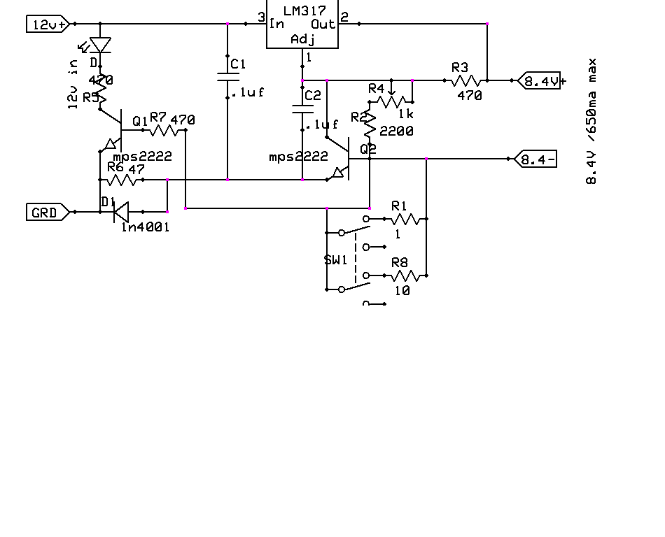

oups on input polarity. Am assuming the S8232 will take care of charging the batteries but would an actual LI-PO charger with output of 8.4V/650ma+

Now you have an LM317 battery charger circuit designed for a lead-acid battery. It senses the max allowed voltage on the battery of 8.4V but it shuts off too soon when your Lithium battery is only 70% fully charged.
www.batteryuniversity.com talks about battery details. Maxim has some battery charger ICs and their datasheets explain everything they do.
If you want to charge Lithium Polymer, there are some very simple chips to do that. MAX1555 and MCP71833. I have a nice little MCP71833 board I made up for charging the LiPoly cells I've gotten from recycled electronics. Like mentioned, to charge these things, they are charged up to 4.2V for each cell and then fed current to top it up.
This is not Lithium Ion, though. They are different.

The lead-acid battery charger does not limit the current until it is the 2.2A max for the LM317 (but your battery protection IC does).
It shuts off the charging when the lead-acid battery is fully charged because then its voltage is at the setting of a fully charged lead-acid battery.
The author doesn't know that a Lithium battery is different because its voltage reaches its max allowed voltage when the Lithium battery is only 70% fully charged.
