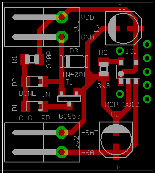

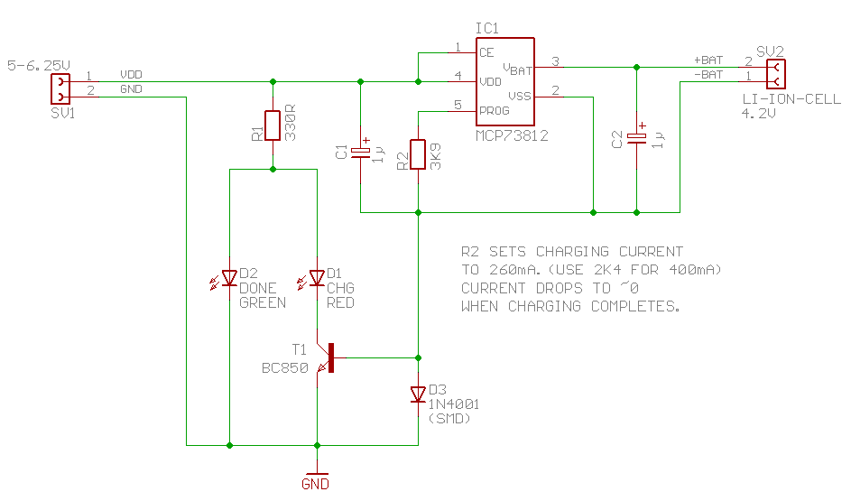

The MCP73812 (TI) is an Li-Ion charger IC for one cell (max charge voltage 4.2V). It's programmable for individual charging currents and has no indication about the charge state of the connected battery.
This circuit is modified to indicate charging and termination of charging.
Board size is 0.76X0.85inches (all SMD, except for connectors)

P.S. The vias around the IC are thermal holes.

But that's not what he asked for in the OP:
li ion protection circuit
A protection circuit is totally different than a charge control IC. The protect circuits monitor current and open a series FET to disconnect the battery in case of a short on the pack. It also has voltage monitoring to open the FET if the cell voltage gets too low or too high.
