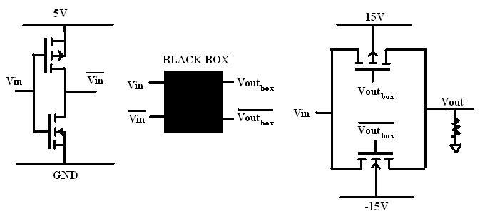

I need to make a level shifter which will change TTL HI/LO (about 0.8V and 2.4V I think), values to +15V and -15V accordingly. I've tried simulating some things but I just can't get it to work :( I'm not asking people to do this for me (I would like to complete it myself), but I think I'm stuck, so if ye could give me pointers on how I may go about doing this or links to additional resources online which will aid me I would be very happy! I obviously have +/-15V supplies and can only use transistors/resistors/capacitors.
The +/-15V is going to go into the gates of two CMOS transistors. It's for a switch, so I have a 0V -> 5V input being fed into an inverter (which I have working), giving me a 5V -> 0V output of that stage. The switch itself consists of two CMOS transistors (one P and N type in parallel), which are controlled by the gate voltage, which has to be +/- 15V. So it's the part between that I must get working.

A CMOS transmission gate requires complementary signals to the two gates, i.e., +/-15V on the N-channel, and -/+15V on the P-channel. Is that what you need? If so, do you mean that you are going to take your input signal, and the inverse of it (which you said you have) and drive a level shifter with each of them?
To make a level shifter, think of an inverter that translates 0 -> 5V to 0 -> 15V. From that output, think about how you can make another inverter that swings from +15V -> -15V. Remember you can use PNPs as well as NPNs (on PMOS as well as NMOS).

Hmm. I'll attach an image of it ... God knows I'm not gonna write a thousand words ;)
That make more sense? Just did it on paint ... so bear with it. I have everything besides my black box designed and simulated. It is possible that I have misinterpreted the assignment .... but I don't think I have.

My understanding is that the transmission gate is a given. Maybe he has a high-level analog signal he wants to switch. His problem is getting from 5V logic to +/-15V.
What Ron H said. I probably wasn't very exact in my explanations. My bad. In my paint-diagram above I made a mistake ... on the switch side (RHS), the Vin should be Vin2 ... or the LHS Vin should have some sort of controlling reference in its name.
Think about it as an analogue switch which can be turned off by TTL signals. LO => Switch off (open circuit), HI => switch on (closed circuit). That make more sense? But it (the switch), must handle +/- 15V which is why I need the shifting in the first place.
However, I've come up with a solution to my problem, thankfully, somewhat of an abstraction of Ron H's hinting above. Queue paint ... Nah. Only kidding. Have a p-spice simulation to screen shot:
The idea is that I subtract 2.5 volts from the output of the inverter, which will either give me 2.5V or -2.5V depending on the output. I then amplify that by 6 and -6 which will give me my desired gate levels. I don't yet know how to do this so I used the magical components that p-spice let me use, sum and mult blocks in this case. Could someone throw some pop words about referring to things I should go research to do the summing and multiplication blocks? Obvious answer: search Google. Have done, but I'm getting a lot of holiday advertisements ... yes. Even with the words transistor :)
Obviously, what ericgibbs suggested would be perfect but the problem about that is that it's a design assignment and I think we are meant to use transistors and as little silicon as possible ... hjames ... that not called plagiarism ;)
NOTE: Attachment is in place of the black box posted yesterday.

Ok. So are ye suggesting I make a BJT summer and amplification stages to get my desired voltage levels? That much I can do, and I know how to do. Or would Ron H's three-inverter solution work better?

Just one question before I do that - Would you recommend I do what you suggested earlier (0->5; 0->15; -15->+15), or what I suggested? And if it's the former would a BJT solution be best? Or MOSFET/CMOS? Thanks.
Do you have any switching speed requirements? That may have some bearing on the method you use.
Sorry, Nigel. Is, my good man. Is. Present. Ye familiar with the **broken link removed**? It's basically that but with some differences ... ton = toff = 100 ns .... Ron = 25:eek:hm: and a bandwidth of 100 MHz, Is(off) = 1 nA. All those parameters I can deal with in due course, but first off I want to get the layout right before I start tweaking it, if ye get me.
Are you using discrete MOSFETs for the analog switch? If so, what are the part numbers? This matters a lot in the design of a driver.
EDIT: ADG201A isn't an assignment, it's a part. What are you doing with the analog switch?
