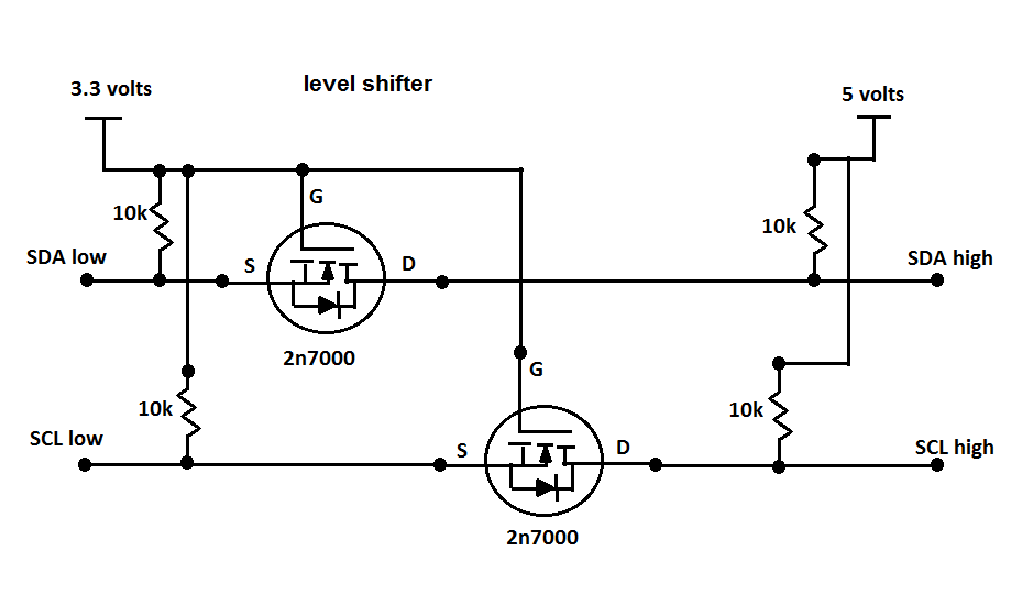

Looking for confirmation I was going to make a level shifter like the drawing of the sch.
Just wanted so input about this.
Many 2N7000 Mosfets WILL NOT WORK in that circuit because the datasheet shows a max threshold voltage of 3V for a current of only 1mA.
SOME 2N7000 Mosfets will work so you must buy hundreds of them, test them all then select the ones that have low threshold voltage at a fairly high current.
Or use more suitable Mosfets instead.

Thanks Uncle $crooge it figures
Well I have a 1000 of them but I'll look for something closer to a BSS138
John thanks those are both good , I have them both bookmarked.
I was just running the numbers in my head and the 2n7000 don't look good for this. But I've seen it used.
