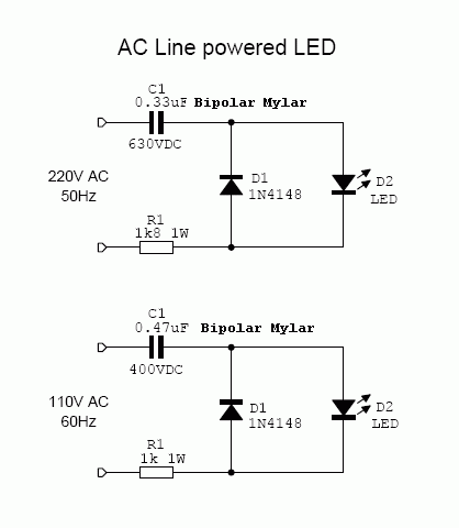

This may seem a silly question but I ve been asked the question and not sure of the answer, is it possible to put LEDs in series to run them of 220v ac?
I said I didnt think it was possible, am I correct?

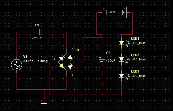

You can actually run using AC230 without a transformer with just a capicator, but i must stress that it is dangerous as you are dealing with live voltage. Simply to a 470nF, 400V and above capicator in series with it. This way, that series will only draw around 20ma of current. But since it is AC, you will realise a flashing effect. If you want to run it on all the time, simply add a retifier & filtering cap. You can run about 90 over leds in a series but each series require a current limiting cap.
Below is a circuit to do it, but i must warn you to be extra careful with it.
One thing he didn't mention, the capacitor MUST be a special type, rated for this type of use!.
LED's will work on AC, but they will only be illuminated on 1/2 cycle, and they need to be protected from the reverse polarity of the other 1/2 cycle.
This protection can be in the form of a single diode in series with them.
LED's in series also need a current limiting resistor.
As it has been said before by other posters that running them off the line voltage can be dangerous if proper precautions are not taken.
But if you want to put a bunch in series to run on 220 it could take over a 100 LED's, as the typical forward voltage for Red,Yellow and Green is 2.0 volts, for White is 3.2 and Blue 3.8 volts. These voltages are at forward current at about 10mA.
The best way remains a DC wall-wart and a series resistor.
My new 120VAC Christmas tree lights are sixty 2V LEDs in series with a diode. No cap or resistor. Since they are half-wave and light at 30Hz, they flicker.
