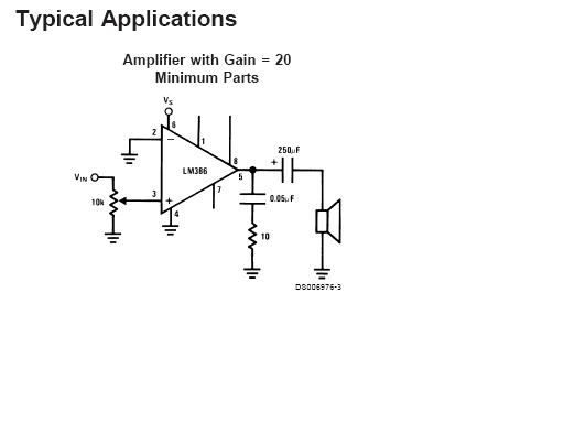

The datasheet shows a 0.05uF capacitor and a 10 ohms resistor.
Not 0.22uF and not 0.022uF capacitor.
Not a 10k ohms resistor and not a 20 ohms resistor.
The LM386s will become hot when they operate at continuous full power into an 8 ohms speaker with a 9V supply. The full power at clipping is 0.6W. The heating in each IC is 0.8W.
The Little Gem Mk2 bridged amplifier has a 4 ohm speaker so its output power will be very low and its heating will be very high.

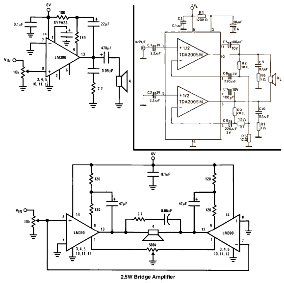

It is usually best to follow the advice of the IC manufacturer. If they recommend a snubber circuit then use one.
The LM390 is nearly the same as the LM386 except it has bootstrapping for more output power and has a larger case.
It is shown bridged with a snubber between its outputs that has the same values as a single amplifier.
The TDA2005 is a bridged much higher power amplifier for cars. It has a separate snubber circuit at each of its outputs to ground.
