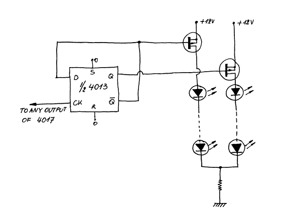

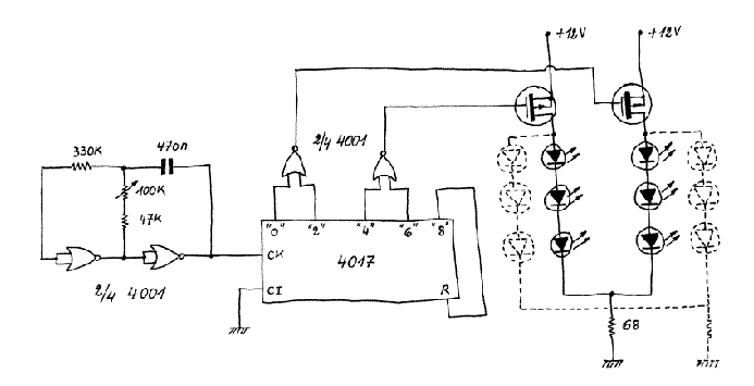

Hi Asunachan,
The first part is the strobe, the second part is the "wig-wag".
You can use any P-channel mosfet you can get your hands on, like
IRF9510 to IRF9513; IRF9520 to IRF9523; IRF9530 to IRF9533;
IRF9620 to IRF9623; IRF9630 to IRF9633, . . . or even BS250's.
The 68 :eek:hm: current limiting resistor was selected for use with
three blue leds with a forward voltage drop of 3,3 volt.
Do you need a siren too ? :D
on1aag.

on1aag said:
Hi Asunachan,
on1aag.
....Did you say siren!? Oh yes that would be wonderful! Thank you!! My attempts at locating something like the real thing has been difficult. The closest find was a MP3 player with a recorded siren
So the first diagram is the Strobe LED's and the second is of the wig-wag ones right?
