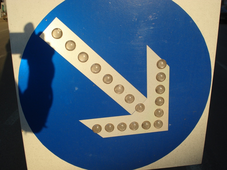

Hi, i want to make a traffic sign LED and i want to turn on 19 LED. every LED consume 20-25mA and i need to design a power source that give every LED just 20mA. could yoy help me with this? how should i connect the LED's? parallel or series&parallel?
should i use resistor to limit the LED current? resisitor is increase the power consumption, is there a better method? power consumption is very important for me, because we want to use solar cell and battery for this LED traffic sign.

i want to make something like this and i want to know that what kind of LED do you suggest?

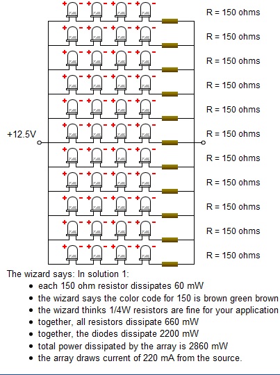

i have done this and it works well for 44 LED, but there is a problem. if one LED is going out of order we have 4 LED off (one row is turning off) what can i do to solve this problem? (if one LED is out of order only one off LED)

We use a 3v9 zener across each LED to keep the other LEDs on when one fails.
It's a lot of extra componentry but is needed when you have long strings.
Or use one resistor per LED, But you have not told use what this is for, who brite does it need to be? Andy
i want this for traffic sign so i will use solar cell and battery charger and battery for this project. power consumption is very important for me because it should work without solar cell in the night and without the electricity so you think the zener diodes are a good idea?
