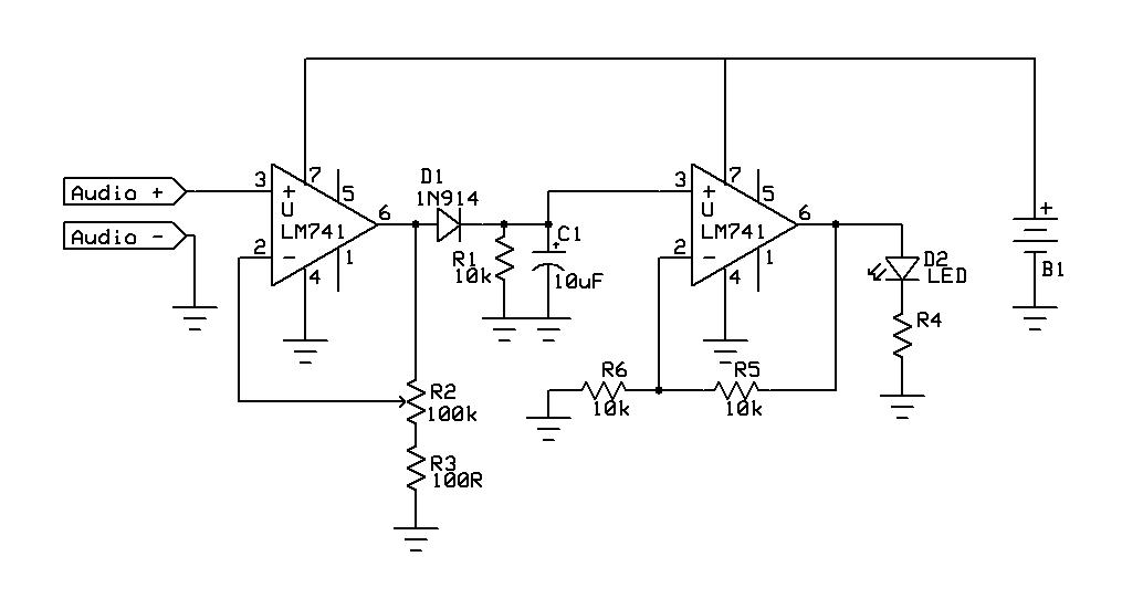

An op-amp would work best for the amplification because you can control how much the signal gets amplified. I have attached a schematic that is similar to an idea I was messing with a while ago. I have modified it for your purpose so you can change the effect the way you want to.
R2 controls the gain of the audio signal
R3 limits the gain to a maximum of 1,000 (actually 1,001) the gain will be R2 resistance (measured from the output of op-amp 1 to the inverting input) divided by R3 resistance (measured from inverting input to ground)+1
R1 and C1 determine the amount of time that the LED will stay on, to adjust the time constant follow the equation 1.1*R1*C1, the result will be in seconds.
R5 and R6 can be adjusted for any additional gain needed, sometimes a lower gain at op-amp 1, and a higher gain at op-amp 2 will work best depending on the input voltage.
R4 can should be determined by the equation: R = +V - VD2 / ID2 where +V is the battery voltage (which will be the maximum output of the op-amp), VD2 is the forward voltage drop across D2, and ID2 is the current needed by D2.
ex: LED = 1.5V, 10mA with a 12V supply; (12-1.5)/0.01A= 1050Ω (1k is close enough)
B1 can be any voltage between 5V and 30V

The audio circuit posted won't work:
1) Its 741 opamps are 43 years old and are spec'd with only a 30V supply so many don't work when the supply is 10V or less.
2) Its input is not biased at half the supply voltage so it will not work.
3) Its rectifier is not inside the negative feedback loop of the first opamp.
