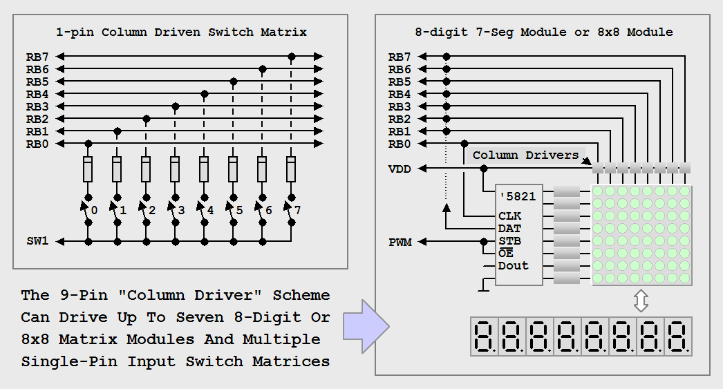

If you're interested in something like the 9-pin example below which supports up to 7 modules (either 8x8 LED matrix or 8-digit 7-segment displays), let me know and I'd be happy to pass along the driver source code. Each module uses a single driver IC, 8 column driver transistors, and provides PWM brightness control from super-bright to black.
Regards, Mike

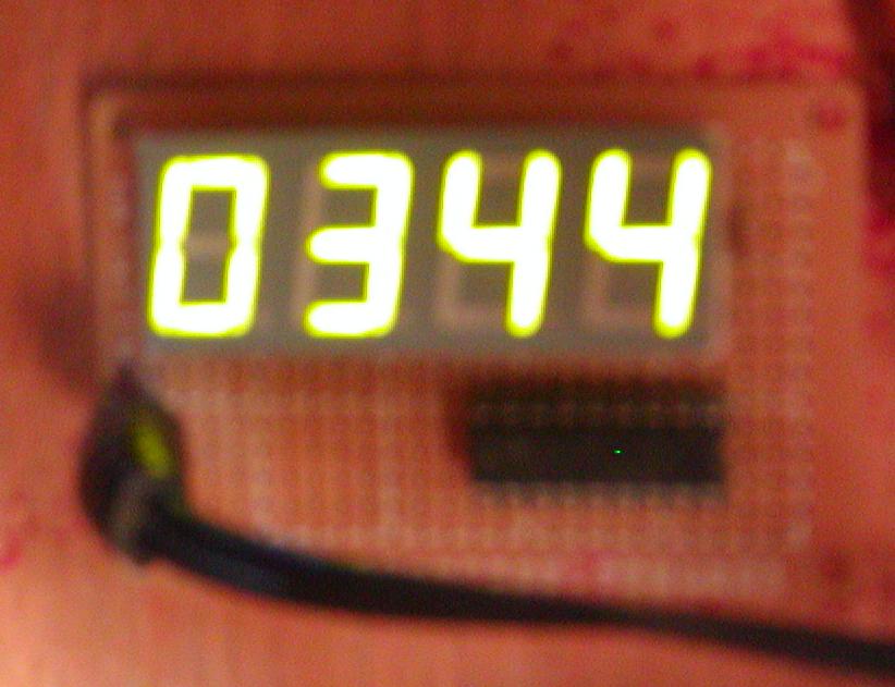

I agree. There is nothing wrong with your design considering the scope of your tutorial. My Charlieplexed display experiments showed you could get 'decent' brightness by directly driving the displays.
But I did discover a significant increase in brightness by simply adding a column or row driver transistor (which ever way you're scanning) and thought I'd pass along that observation.
The four transistors in the circuit below really make a big difference (sorry about the fuzzy picture).
Mike
<added>
I should also mention that there are some very low current (3-ma/segment) 7-segment displays from Fairchild and Agilent that provide very good brightness levels when directly driven in a multiplexed design. I wonder if there are "low current" discrete LEDs available for your 8x8 matrix?
